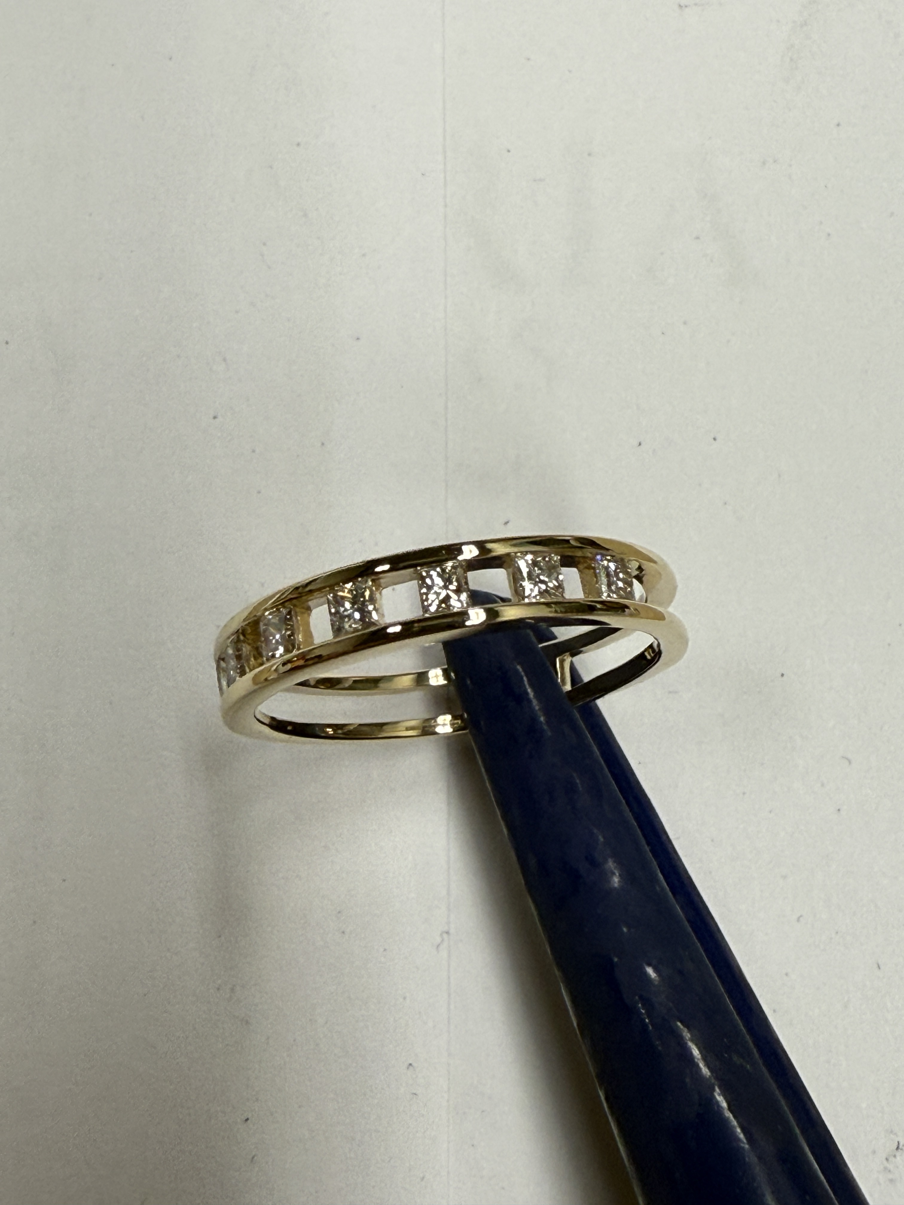

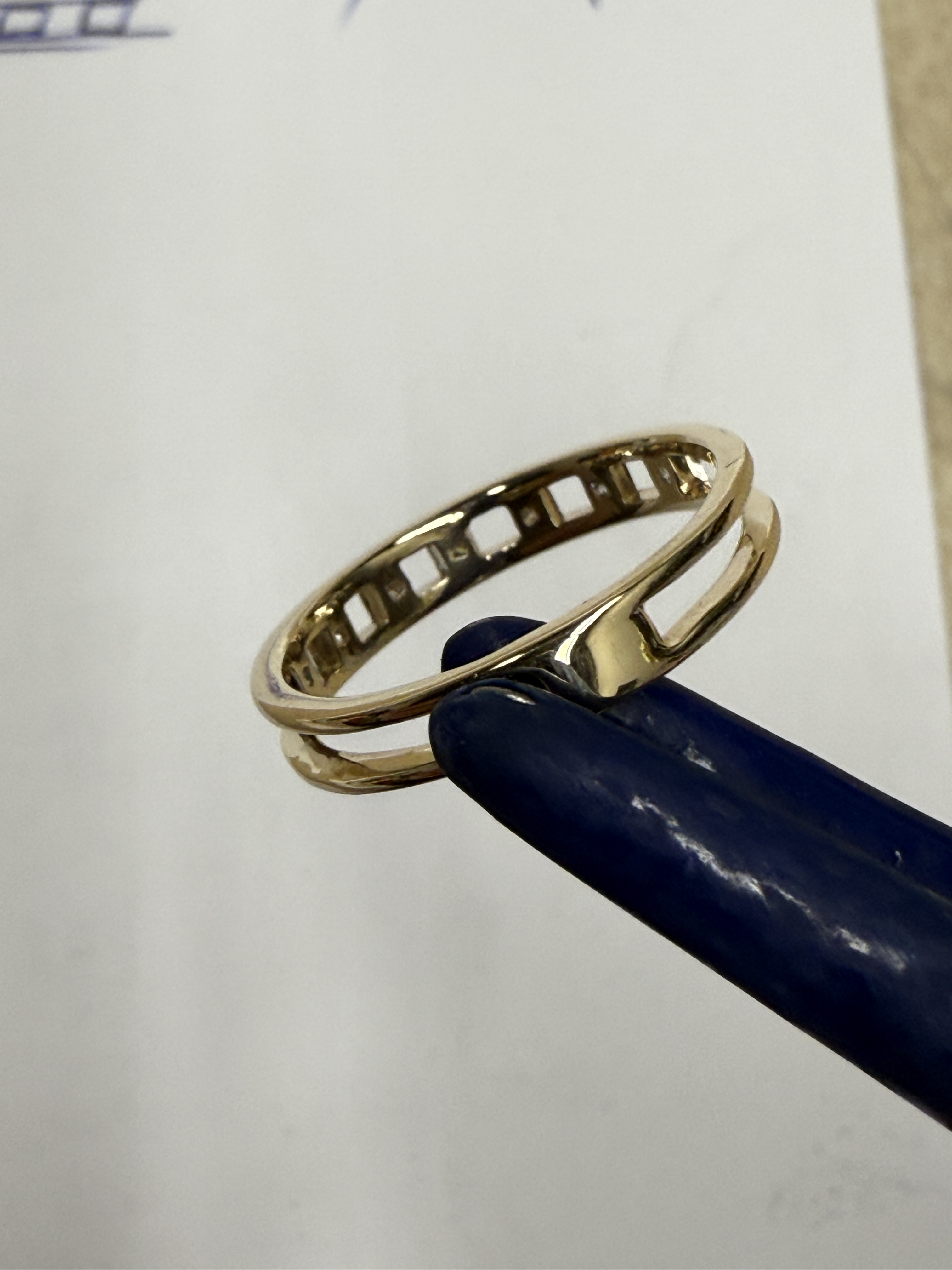

Just had this ring this morning for repair and thought of this post. Close to the idea that you want to do
Oh my god!! How funny is that. Thanks so much, that’s actually quite helpful!!
