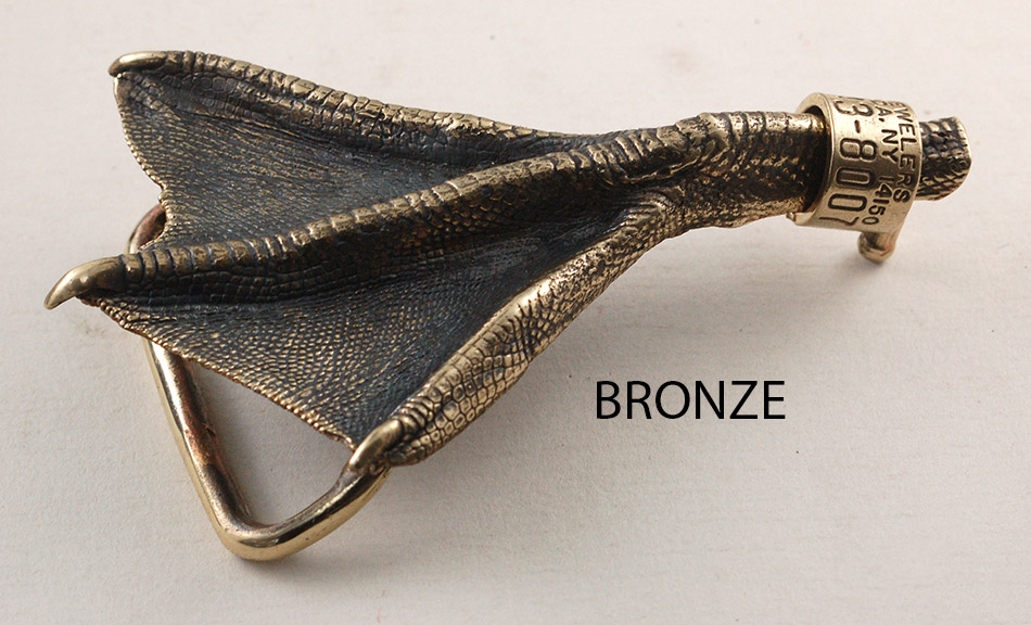

I use “Special H silicon bronze” from Belmont Metals Inc. to cast belt buckles I sell on Etsy. Melts at a higher temp by torch or gas furnace. Very recastable. I just keep reusing the sprues and buttons. If I need to do any repairs, I laser weld with bronze TIG wire. I get a nice black with Berg selenium toning solution. (used for photographic toning prints) I get this from B & H Photo in New York. Apply full strength to work with a brush or cue tip and heat with a torch. Hot, but not red. Wash off and then do a little more if necessary. Stays on good. Does not come offf in ultrasonic.
