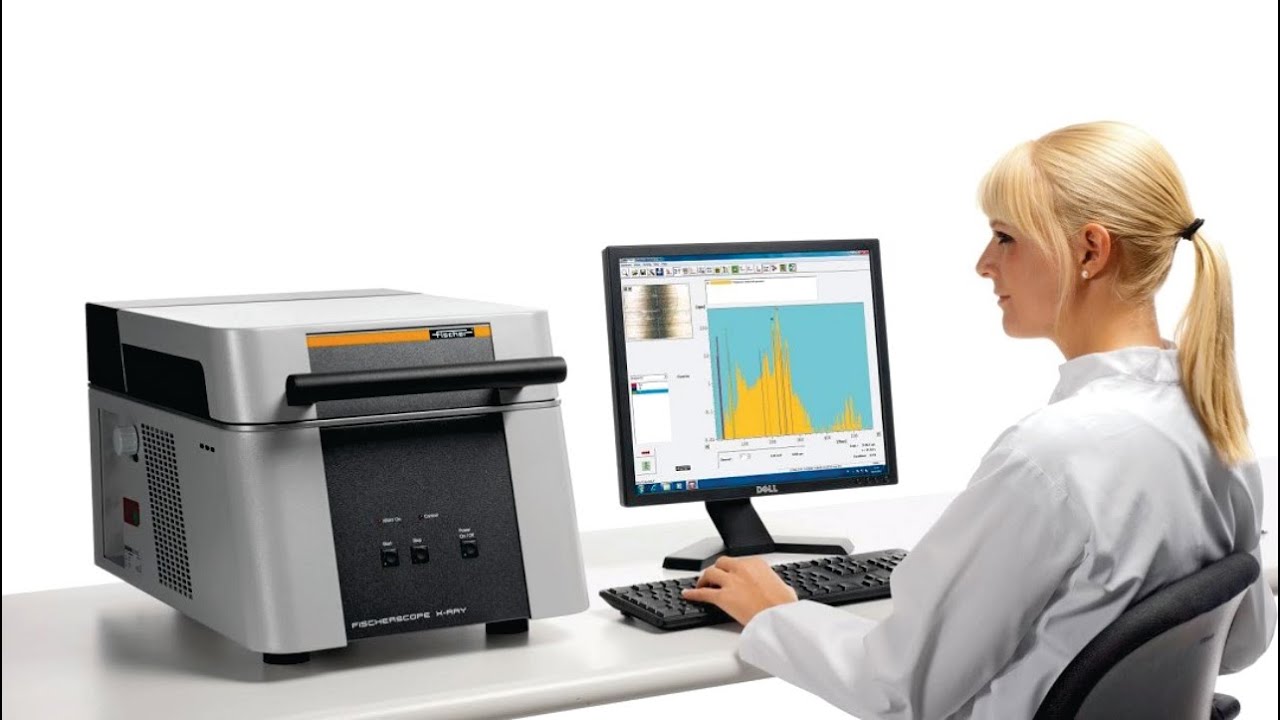

Yes, I am sure, because I have a German-made alloy tester. It gives me the percentages of metals with an error rate of 2 per thousand
It measures all trace elements in an alloy (not just the precious metals)?? Wow. Could you possibly give a link to such a tester? Thanks.
