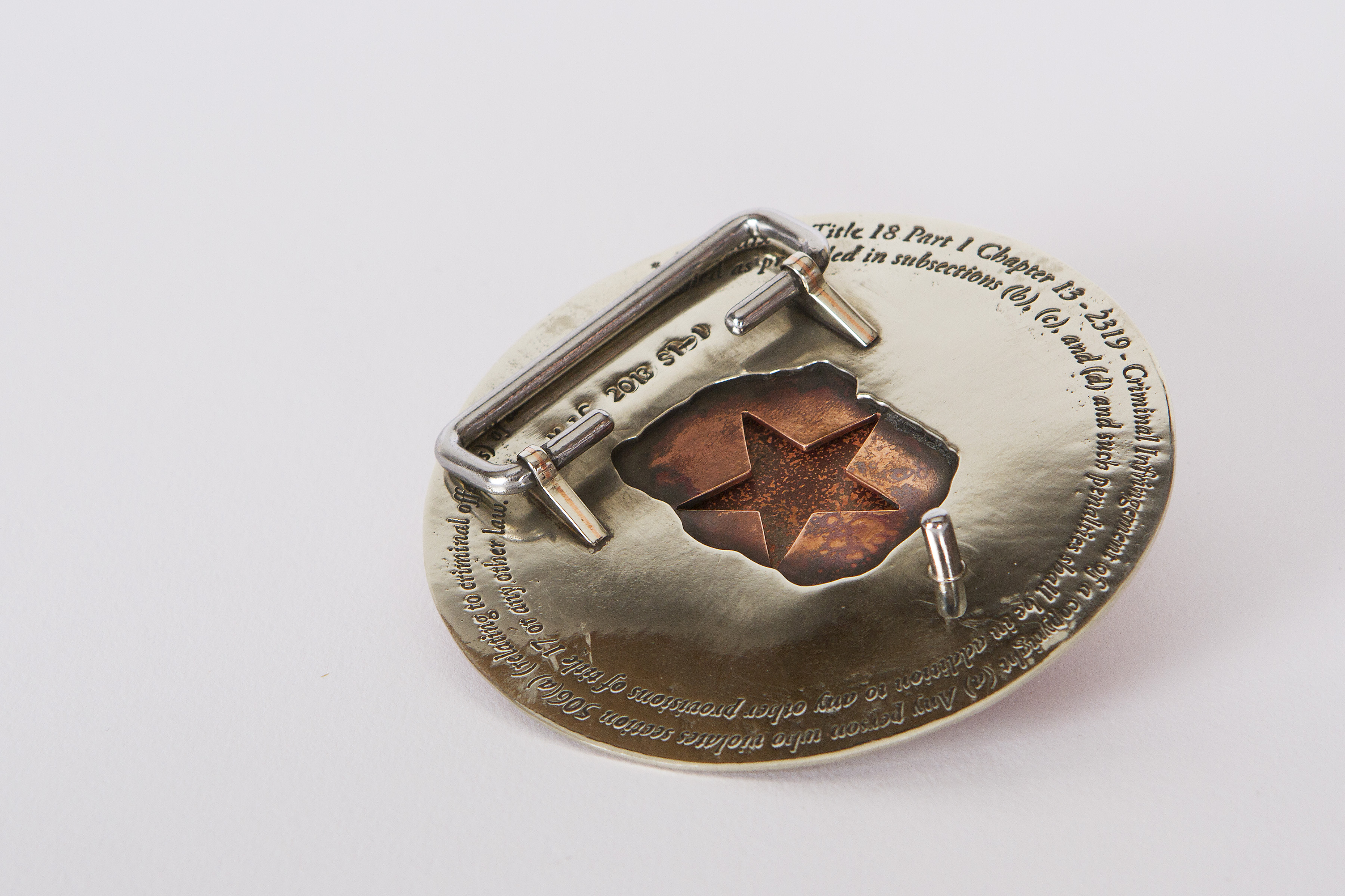

Captain Copyright (Back) - Changing Hues
Materials: Copper, Nickel Silver, RG-45 Mild Steel, Lead-bearing Enamel
Dimensions: 3" Diameter
A belt buckle discussing the issues of abuse of copyright law and merchandising. Created using the Champlevé Enameling technique on 14 gauge copper plate etched by a standard Edinburgh Etch formula. The back piece etchings were also created by an Edinburgh Etch while the mechanism and the device were designed and cut by hand. Ninomiya Japanese Lead-bearing Enamel was used (fired at 1410 degrees F) to achieve the best possible color for the piece.
Photo credit: Amanda Umberger Photography
