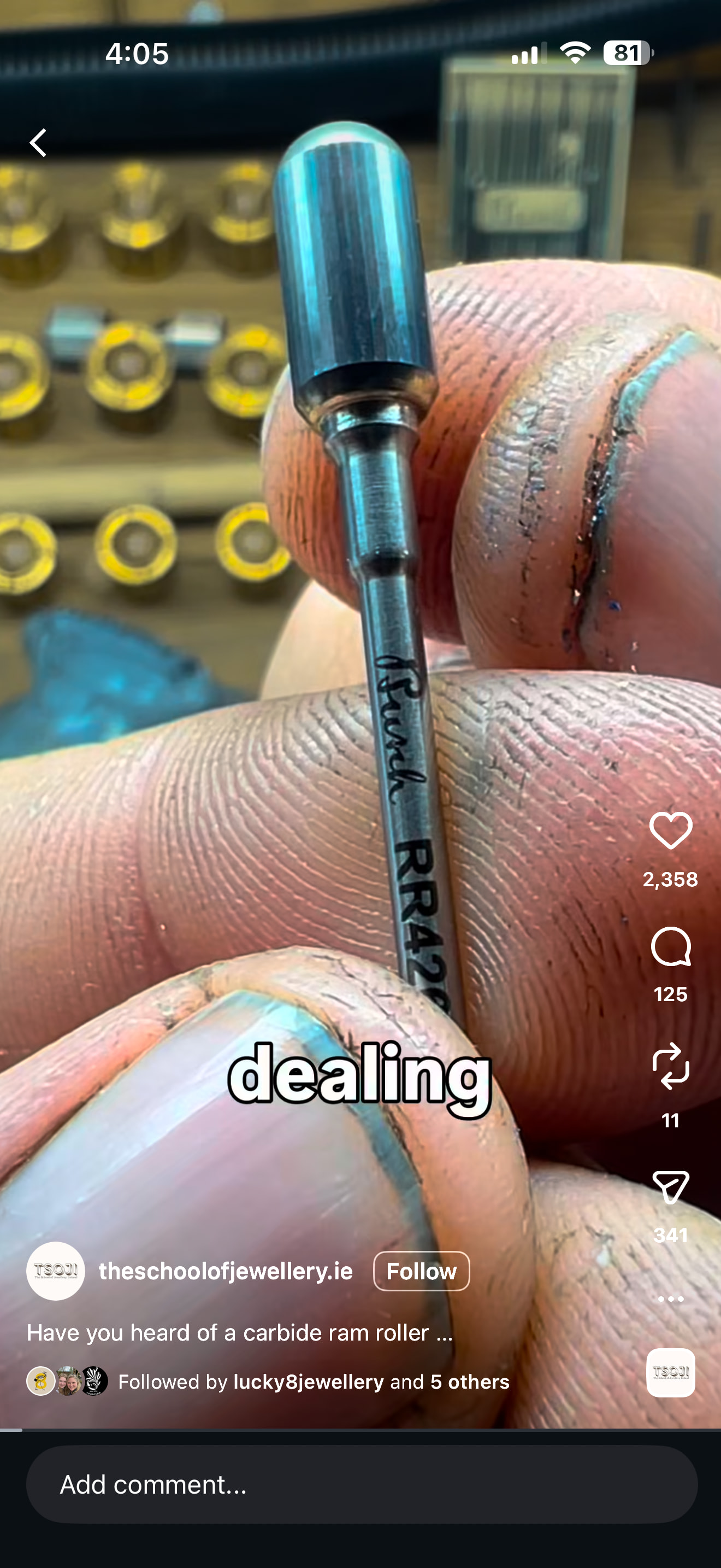

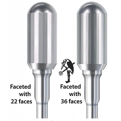

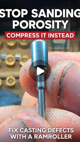

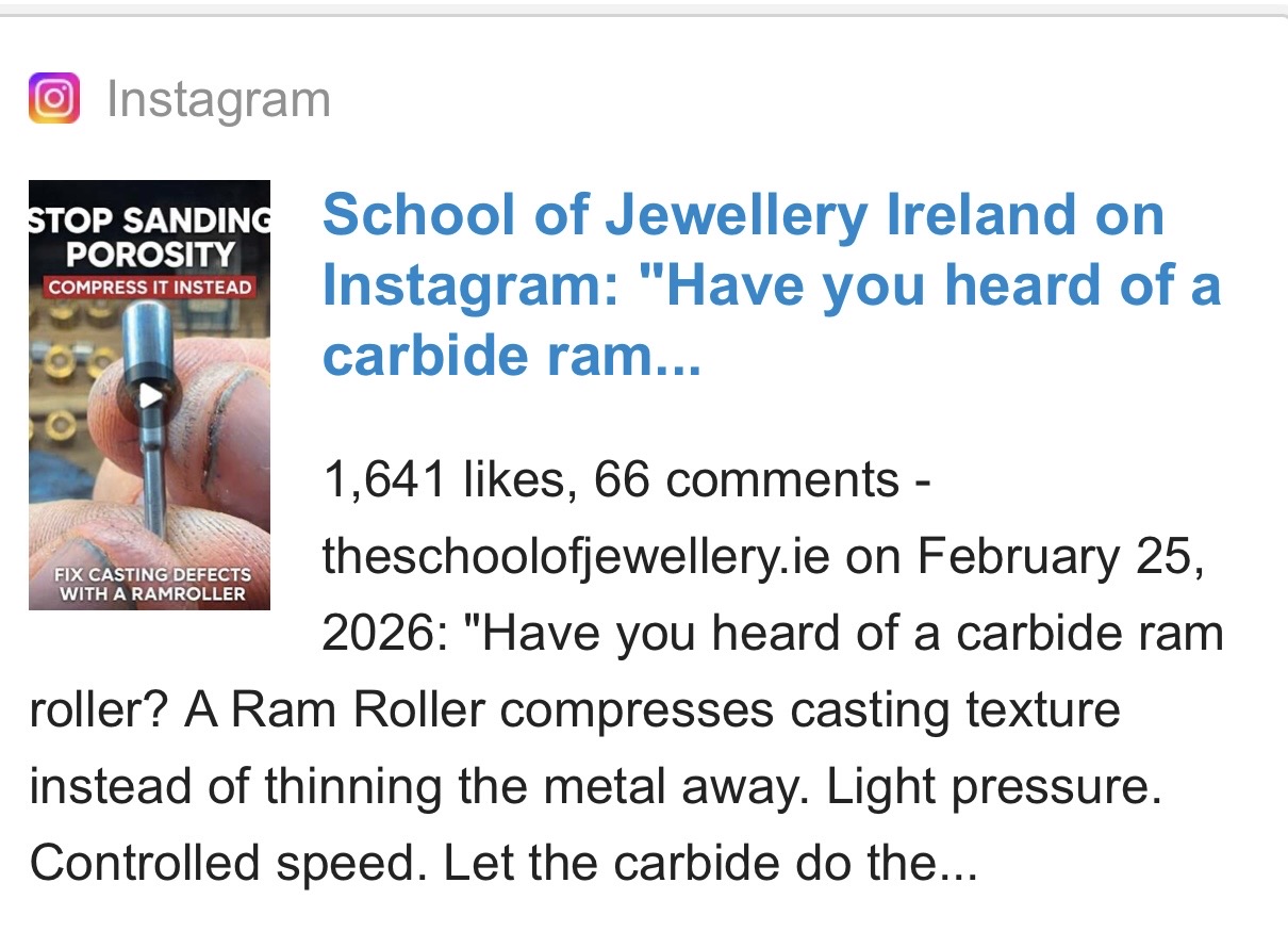

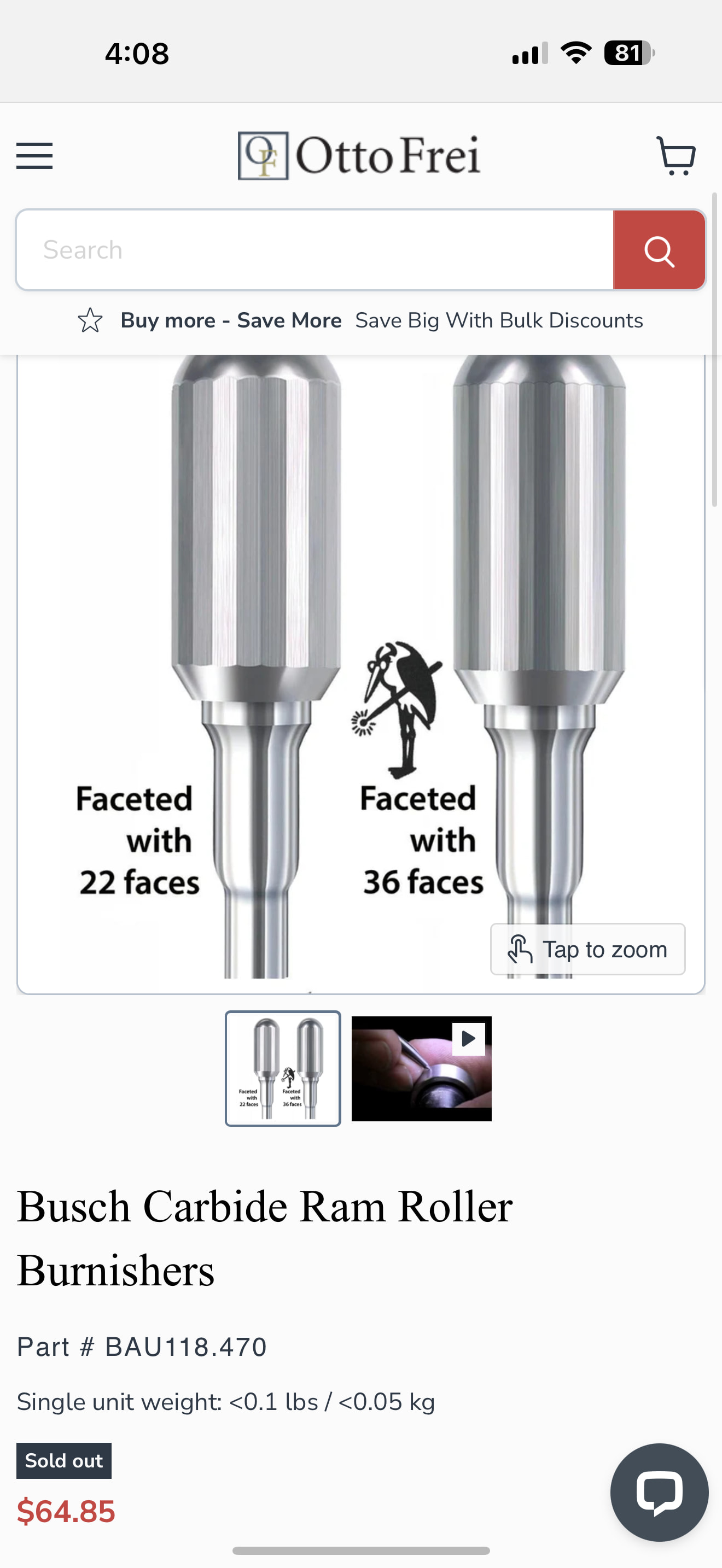

Busch carbide ram roller for burnishing
Hi,
i saw this and need to buy! and thought i would share!
julie
here is a pic, for posterity, in case the link disappears years from now
