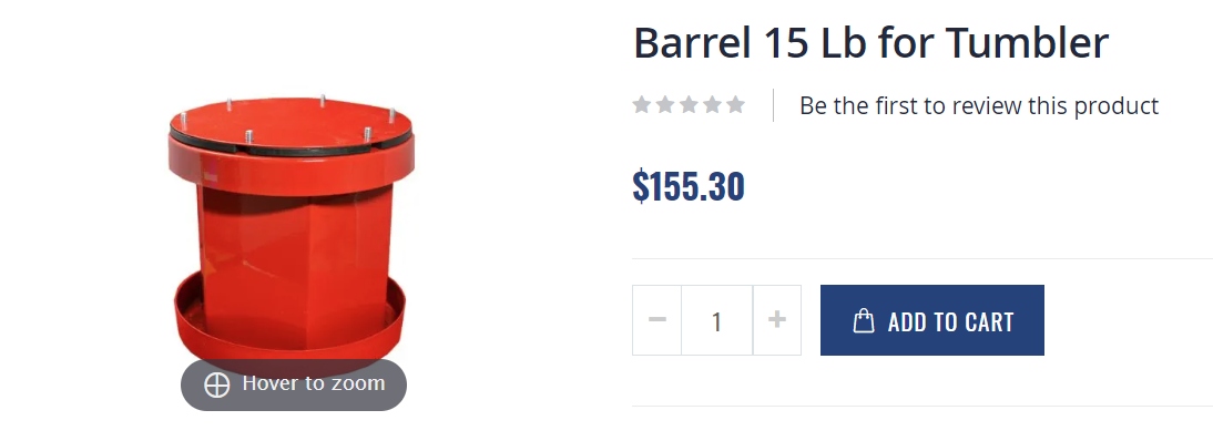

I take exception to their blaming the issue on ‘lower end economy barrels’. Here is the kind of barrels I use, and I don’t call that ‘economy’:
Part of the description for the tumbler I use reads:
  • Full Speed (barrel rotation 40 RPM): For burnishing and deburring all malleable metals or whenever steel shot is used as the burnishing medium.
At the time I started buying tumblers the Model B was the best choice for me. It has served me well. I use separate barrels for different media to avoid cross-contamination, and have had no trouble with them for many years.
I’m sure you know of the heavy gray triangular ceramic media for very aggressive cut-down. I’ve run 10 lbs. of that with no harm to the rubber liner.
