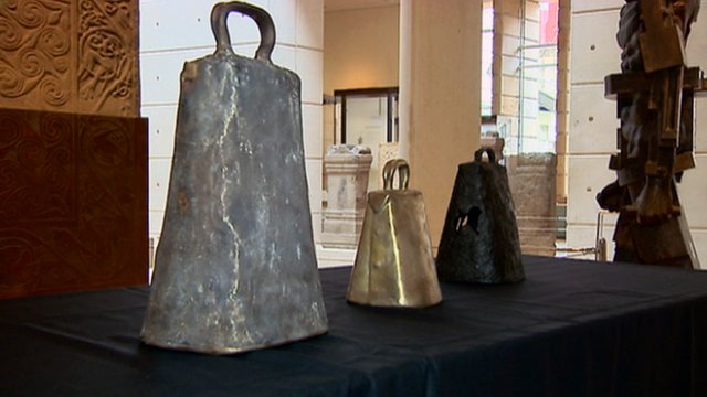

Bronze coating on medieval iron bell
Researchers at the National Museum of Scotland are working on
creating replicas of the medieval monk’s bells, that were made of
iron sheet and somehow given a bronze coating. Apparently the
bronzing part is giving them trouble. Does anybody in Orchidland have
any experience with this sort of thing?

Ive an antique Austrian cow bell here thats made this way, tho the
coating is brass.
Looking at the surface its obvious that the brass has been fused to
the iron sheet AFTER its been bent up and riveted.

I can tell you the method used then is still used in Spain and other
countries for cattle and sheep bells. The steel bell is enveloped in
clay and a small piece of bronze or brass is placed in with it. The
item is them placed in a fire when the clay has dried and heated to
about orange-yellow heat and then when cooled the bell is broken out
of the clay. The bronze or brass melts and coats the bell by
wicking, the seams are brazed with this process as well as the
rustproof coating. Very cheap as done onan open fire rather than in a
proper furnace. No volatolisation or oxidation. Larger pieces have
straw in the clay to bind and bulk fill it andthis turns to carbon.
Nick Royall
Maybe something along these lines may work, heat the bell and dip
it into molten bronze. Try small scale first.
In the news piece, they show a crucible of bronze, but they don’t
really say what they did with it. I would suppose that dipping it
would be one of the most obvious things to try. But I see a reason to
suspect it was done some other way.
If the culture that produced these bells (early medieval Scotland
and Ireland)could bring together enough molten bronze to immerse an 8
to 10 inch bell, it would seem that they would also have very likely
produced some bronze castings using a similar volume of bronze. You
would need at least a hundred pounds of bronze to fill that crucible.
But I am unaware of any bronze castings coming from that culture that
are anywhere near that large.
