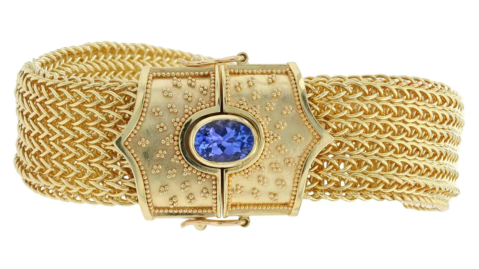

Jewelry making is vast, and that can feel overwhelming at the beginning. My own approach was to focus on a very small area of jewelry making: ancient goldsmithing techniques. Rather than trying to learn everything, I chose to immerse myself deeply in what genuinely fascinated me. That depth shaped everything that followed.
I now teach workshops and accept commissions. Mass production was never appealing to me; I was more interested in understanding material, process, and tradition at a high level.
My suggestion would be to start by asking yourself what truly draws you in, and then seek instruction in that specific direction. Depth creates clarity.

Working in 22-karat gold is a very different experience than working in other alloys. It’s a responsive, forgiving material and actually requires surprisingly few tools to begin, which can simplify the learning process early on.
