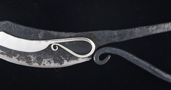

My son and I took a 5 hour blacksmithing Class this past weekend and it was a lot of fun. We each made a knife from a 6"X1"X.25" piece of .7% oil hardened steel. I do a lot of forging so that part was familiar other than the size of the hammer and work needed to move the metal. Steel works very different from silver and gold and I had to adjust my time in the forge to make sure that the piece was hot enough before I tried to forge it. I do make steel chasing tools, but they are a lot smaller and don’t take the time that this knife took. 5 hours later I had a knife. If you ever get the chance, give it a try. When I got home, I decided to duplicate the design in silver. Following is a link to a picture of my two knives…Rob

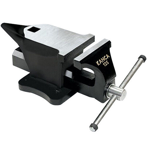

It’s interesting that you brought blacksmithing up Rob, because I’ve been thinking about this anvil/vise from Centaur Forge all week. Part of me really wants to get it because I need a heavier vise. It’s 37.5 pounds and is a cross between an anvil and a vise. With little bit of work you could polish up the flat part and horn. It’s on sale this week, with $10 shipping.
I don’t know if I’ll get it, but it’s been really interesting to think about.
Congrats on both knives! They look great!! Blacksmithing is fun isn’t it!

Nice! The fact that it is forged steel makes a difference. A lot of inexpensive anvils are cast iron. I need to get a bigger general purpose bench vise. I have a small one on my soldering/fabrication bench that I have used since I started making jewelry. I also have a very old cast iron carpenters bench vise that I use all the time to stretch and form rough wire circles into shapes that I can use as bracelet bases. It also supports my draw bench at a height where I am not bending over to use it. Yes, blacksmithing is fun…Rob

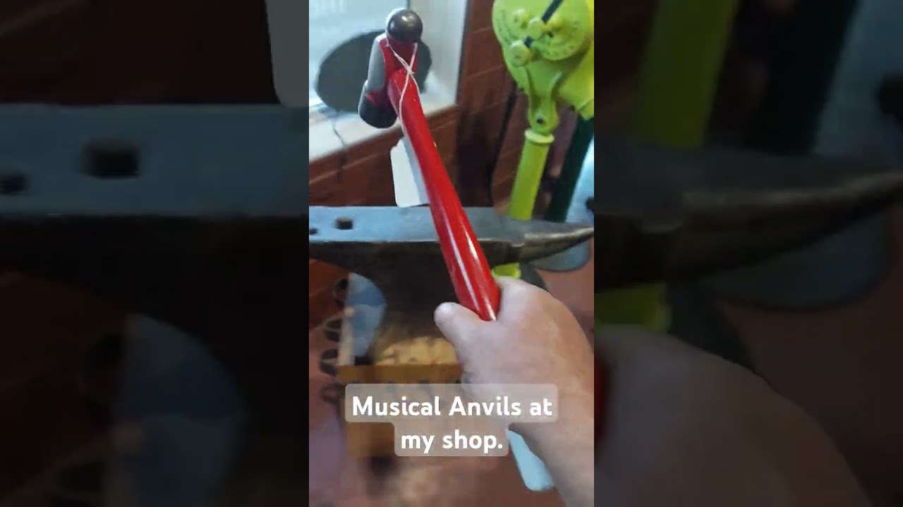

of course after i got the anvil i had to go down the “ring test your anvil with a large ball bearing” rabbit hole
…i had got one to put in my car in case i ever “ran into” an anvil for sale somewhere…(where DID i put that balk bearing…?)

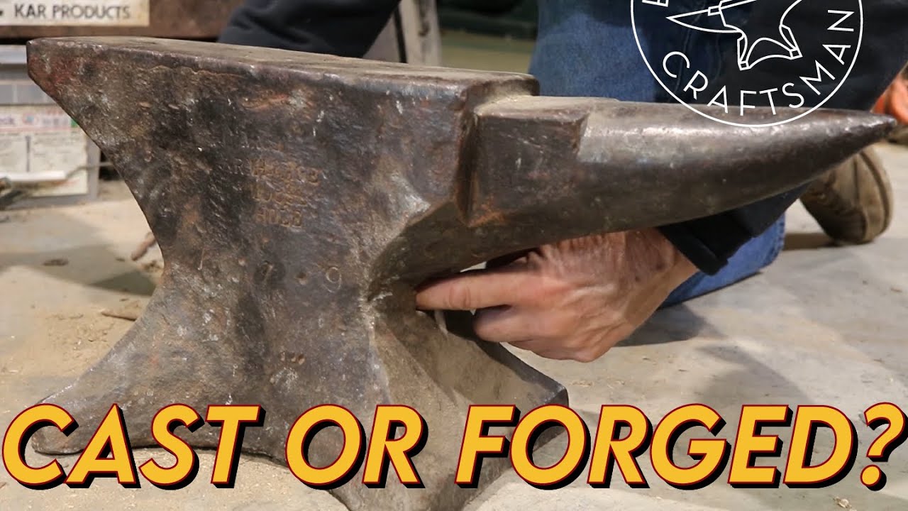

Thanks Julie! Now I know my for sure that old 125 pound anvil is forged not cast.

but…some anvils are called “forged” or “steel” anvils (as opposed to cast Iron) but they “just” have a hardened steel top layer (that “can” become “delaminated”…as illustrated by the different sound/ “dead spot” shown when testing with a ball bearing in one of the videos).
also, as shown in one of the videos, an anvil might not have a “good” ring to it, but still have great rebound…
i figure as long as i get a good rebound, i am good, haha!
