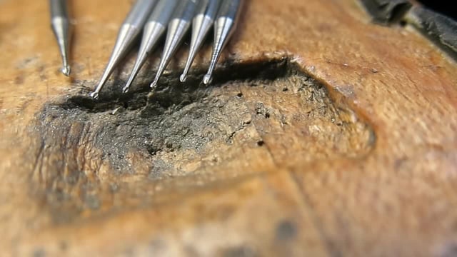

On the first of the 6 videos, I explain how important it is to have
the right size of burs & the correct type of a graver.
I’m into modifying any of the tools I can get to use, Onglete
gravers are my specialty, I explain this in the greatest of detail.
I am in the process of downloading my video’s & they should be ready
for you to view by tomorrow night (Monday).
Here are some ‘before & after’ pictures of some of the items I was
working on.
