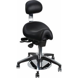

I purchased this setters chair when I wanted something that was small and not in the way as I moved around my new bench area. Surprisingly it was the best change I have ever made for my back! Not having the sharp bend at my hips took so much pressure of my back and it’s great to quickly adjust into the right height for the task at hand. Been raising and lowering my bench for years.

I so want one of theses. Especially after I tried one at the Portland Jeweler’s Symposium. Stuller had them there. The price is a bit steep but my back keeps whispering to me “Buy the damn chair bitch. I’m dyin’ back here.”
