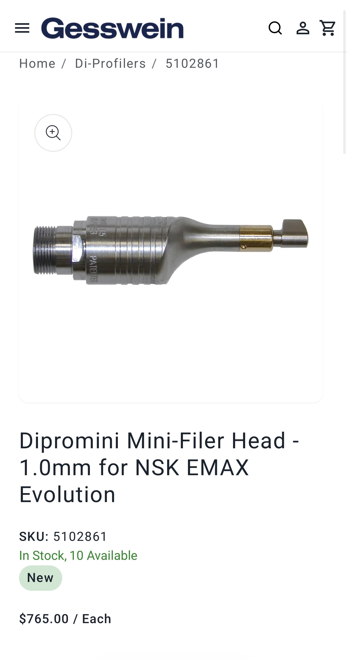

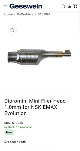

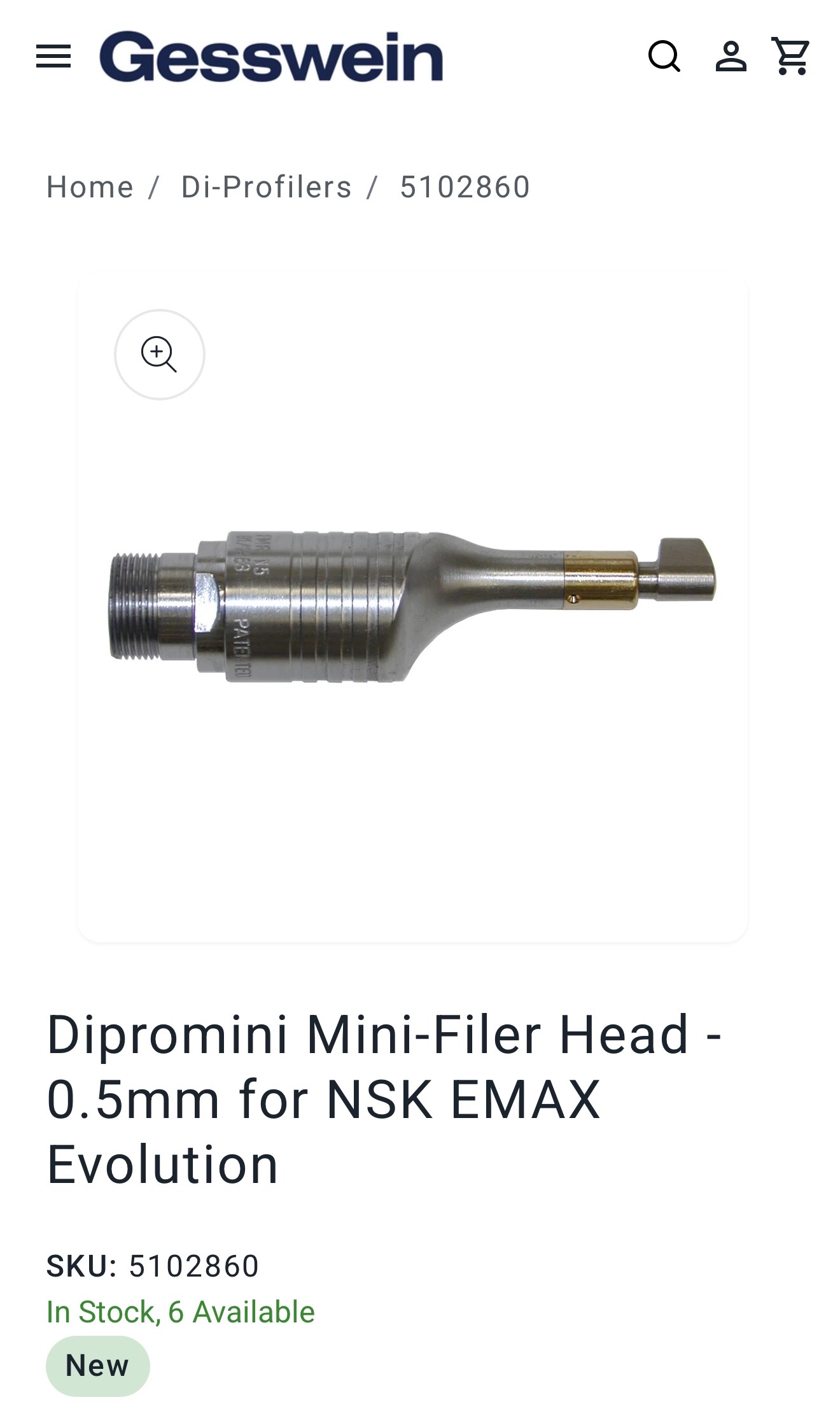

I’ve been using a Diprofil Mini-Filer for a few years now and absolutely love it! It’s spendy ($700 range), but it attaches to your flexshaft, and accepts the small ceramic fiber rods that all the major suppliers sell. It reciprocates back and forth with 1.5mm strokes.
Here’s the link to it on Gesswein: Brush Type Micromotors
I personally use the .5mm thick by 1mm wide sticks to get in to all those tricky little places in my castings. I can’t speak to any of the others you listed, but I can definitely vouch for the usefulness of the Diprofil.
Hope that helps!

That’s exactly what I was suggesting in my previous post. They’re great!
One thing though, follow the warnings as far as time spent using it. They recommend no more than 20 minutes of use at a time. I would use it for hours on end, and at the end of the day, I’d barely be able to move my hand. Vibrations do all sorts of gnarly things to your nerve endings.
