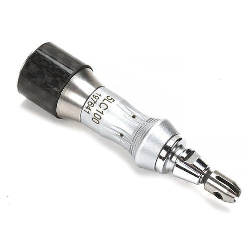

Hmmm…still trying to find the correct glardon vallarbe micro files for that 5LC100 handpiece…not finding anything, yet, that confirms compatibility…ie: handpiece collet size…micro file shank diameter…

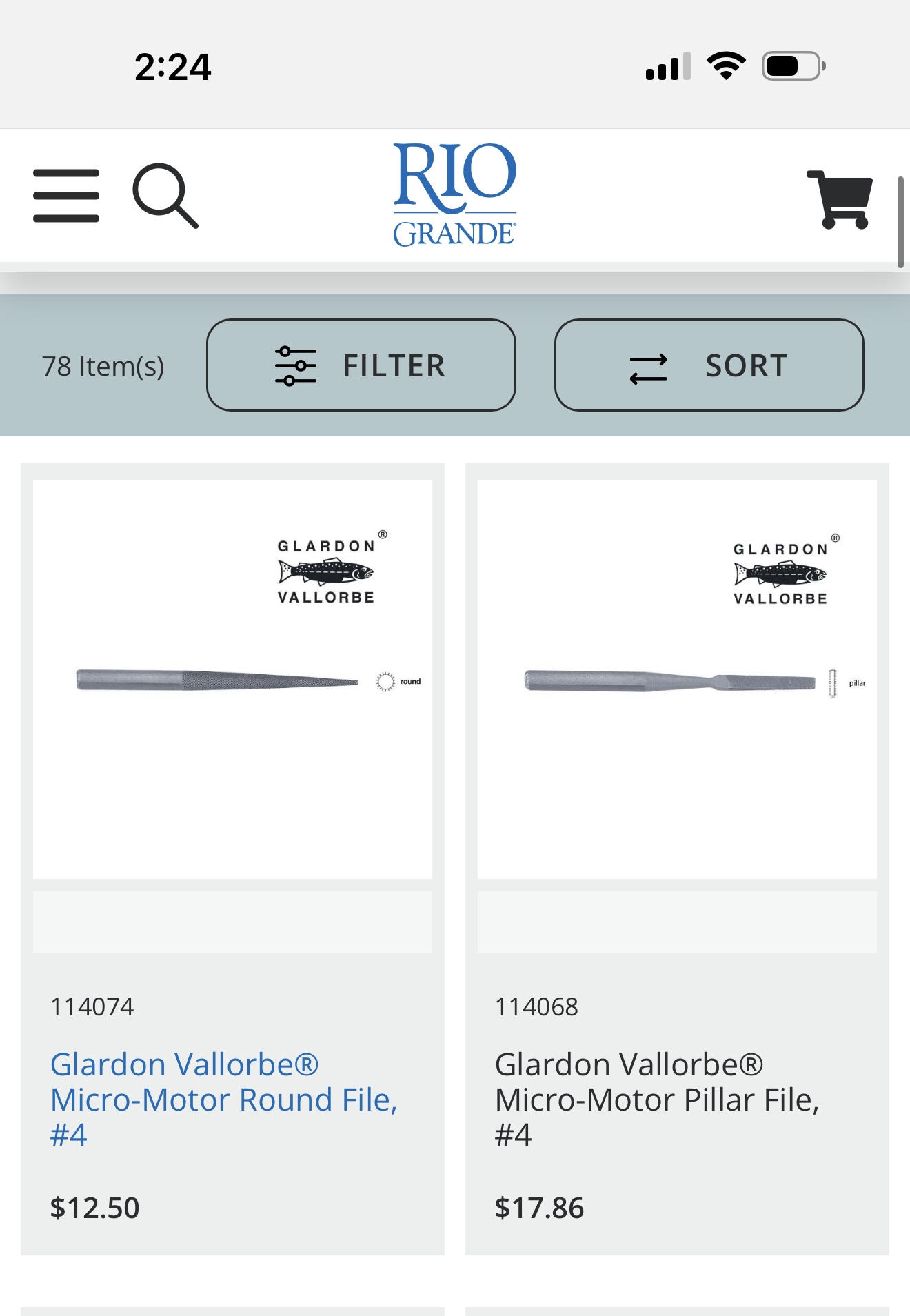

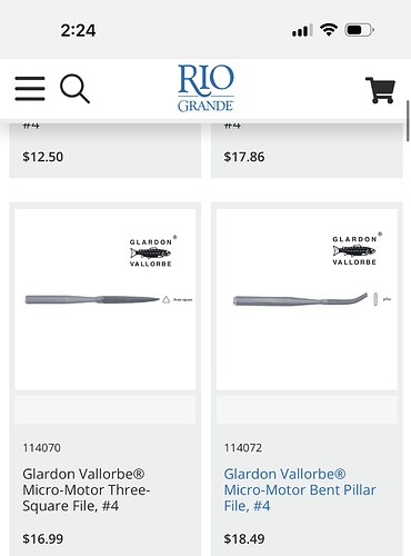

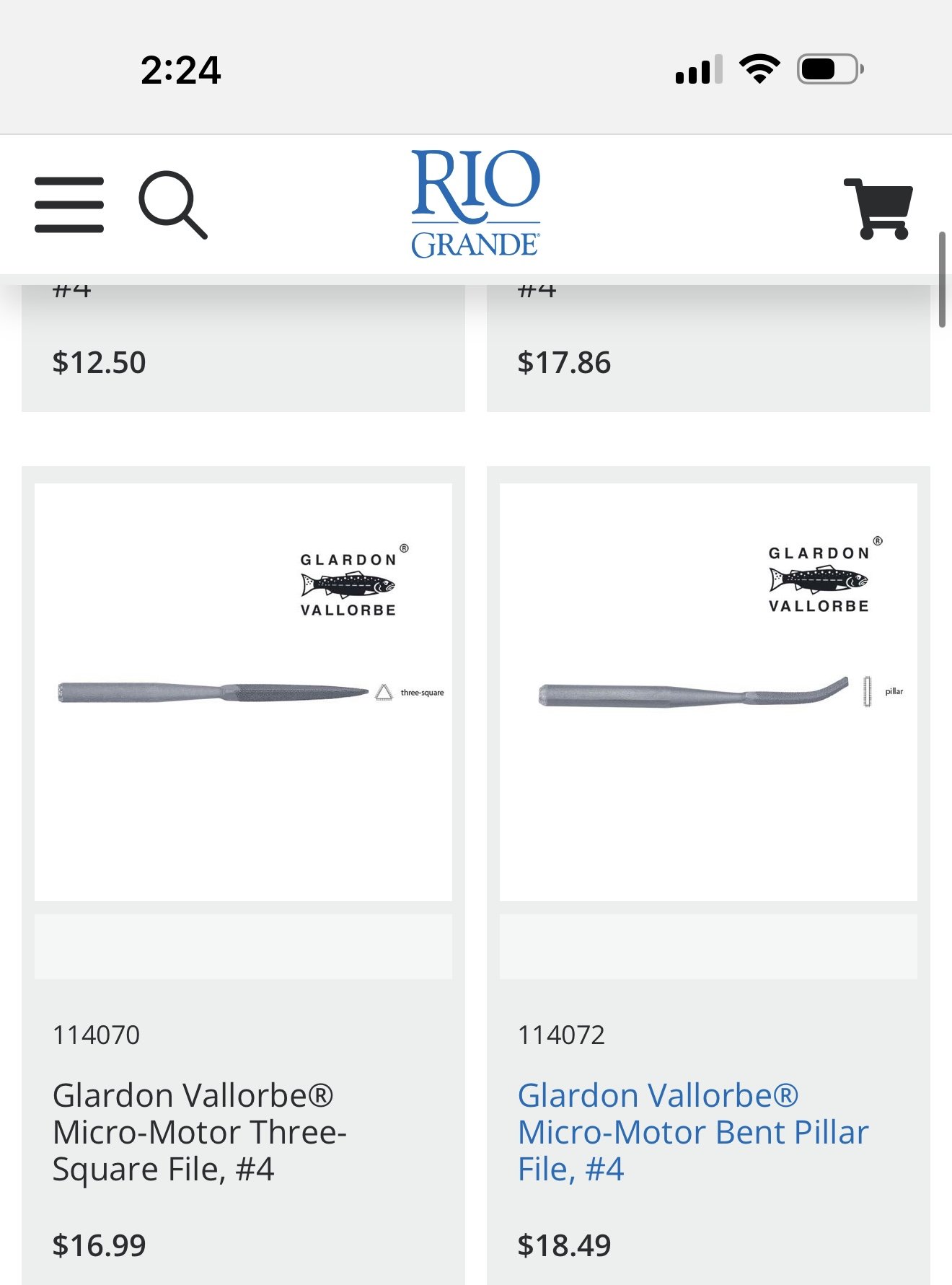

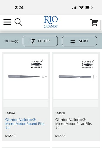

ok, here are some glardon vallarbe micro files on the rio grande website…that says can be used in micro- motor or flexshaft with lapping action in a hammer handpiece…1/8” shaft…
so…it sounds like these micro files work with handpieces that are hammer type…reciprocating…

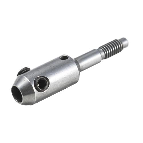

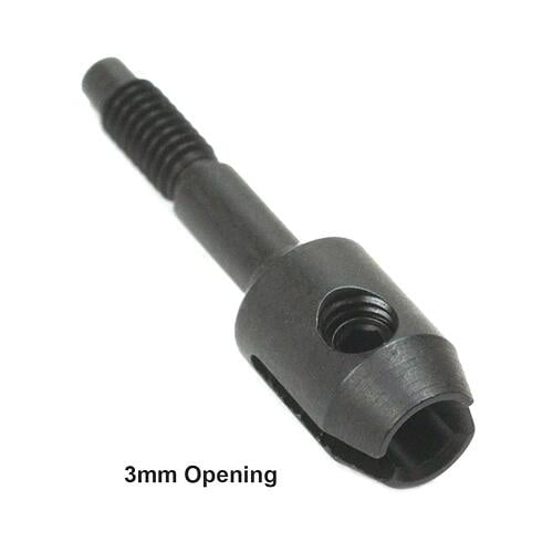

ok, so badeco sells a threaded collet that fits on their hammer hand piece.
and which fits up to 3.20mm shafts
so this should hold a 1/8” micro file (3.175mm)
julie

this badeco threaded collet will also hold ceramic strips…
i am not sure if threading will fit badeco 222 hammer…
it is “sold out” but i wanted to share
julie

FYI, Badeco #260.320 tool holder
per Otto Frei, the set screw uses 1.5mm hex wrench, (which is not included…)
per AI, hex wrenches are measured on the (parallel) flats…not the points

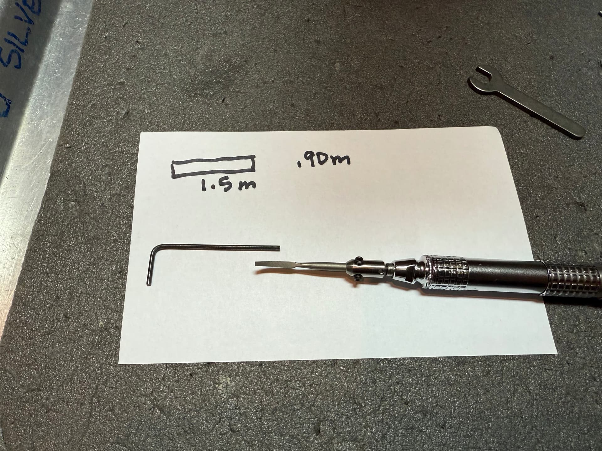

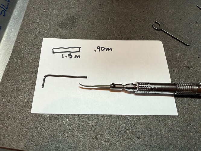

For anyone interested…here is a photo, for scale:
badeco 260.320. 1/8” tool holder
with Glardon Vallarbe micro file-bent pillar- cut 4
1/8” shaft
tip width= approx 1.5mm
tip thickness= aporox .90mm
(shown with 1.50mm hex key for scale,
in a Badeco 222 hammer handpiece
Julie
