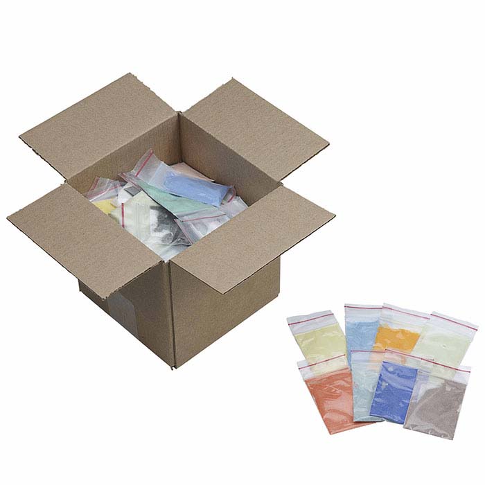

also, Rio Grande sell a complete thompson enamel color sampler box

Thompson sells sample sets of either unleaded opaque (1000 series) or transparent (2000 series) in 80 mesh. Enamel Warehouse is a distributor as well.
