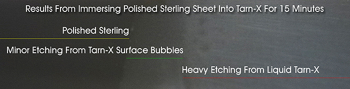

Hello Judy,
Because of time, I will only address the silver dip issue with the
test I performed.
The entire sterling sample below (enlarged from original size of
1/2" wide) was highly polished then immersed in Tarn-X for 15
minutes. Notice the right part of the sheet that was immersed and
the micro-etching that resulted. If you submerge or wipe your silver
with these products, micro-etching can occur within only five
seconds. This etching is so severe that it can only be removed by
machine polishing.
The same piece magnified…
Jeff Herman
