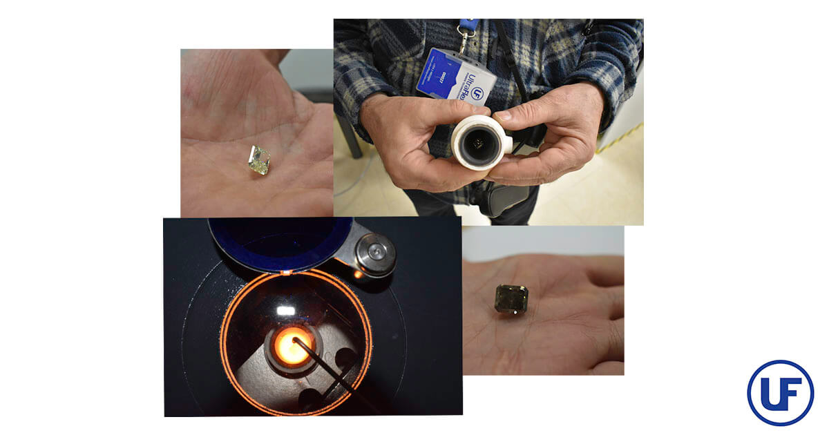

Here’s a little article describing one company’s experience.
But this was done for a prolonged time and significantly higher temps then what is needed for annealing. And it seem to be done with a graphite susceptor, at least according to the pictures.
And as far as I can see on the net, the diamond itself do not heat up in the induction field due to its electric insulating properties.
So I guess it should be safe, if ever the need presents itself.
I agree with the previous post that diamonds are not electrically conductive and are not going to be heated by induction. The example about a diamond heat treatment uses a crucible heated by induction as we can guess by the picture. I have experience soldering jewelry using induction and it is not an intuitive process, if you subject an entire piece to the magnetic field large parts will heat first and small parts after depending of the orientation in relation to the field. Just my opinion is that induction works best with simple parts either small or large but not cluster of dissimilar sizes. Induction heating is an industrial process and should not be considered as a solution to any problem solvable with conventional jewelry tools. Induction can make a very difficult job for a conventional technique very easy for unskilled labor due to its very precise application of heat.
