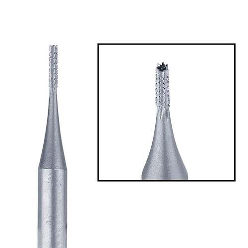

Hi,
are you notching an edge? i am assuming an edge because you mentioned initially using a file…
if so, perhaps consider a square cylinder shape bur…although it will create a rounded bottom, versus a flat cornered bottom…it may be worth the design change to get the time saving…?…or perhaps you can crisp up the bottom with a square file (with a safety side)
if you are looking for a 2mm notch, try a slightly smaller size…
alot of the smaller wheel type “burs” are very shallow, and limit the depth of notch…except the below round edge wheel bur
square (parallel) cylinder burs…more of a vertical chopping versus a horizontal slicing…:thinking:
(i love these finishing burs!)
i like getting the sets first, so i have a variety of sizes…
julie
