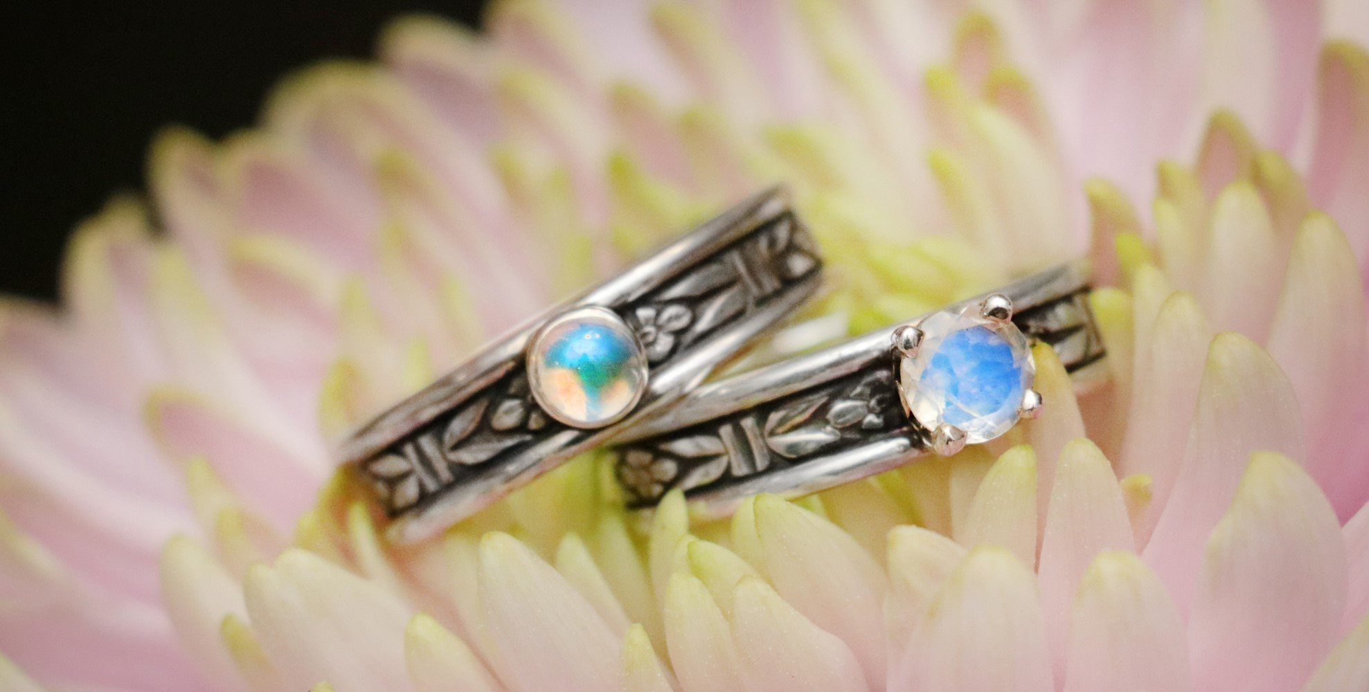

Most of my customers are online, so I have marketed most of my Opals as promise rings. If a customer comes to me with a custom request for an Opal, I explain the issues with hardness and scratching, that it will have to be replaced in the future, and let them decide from there.
