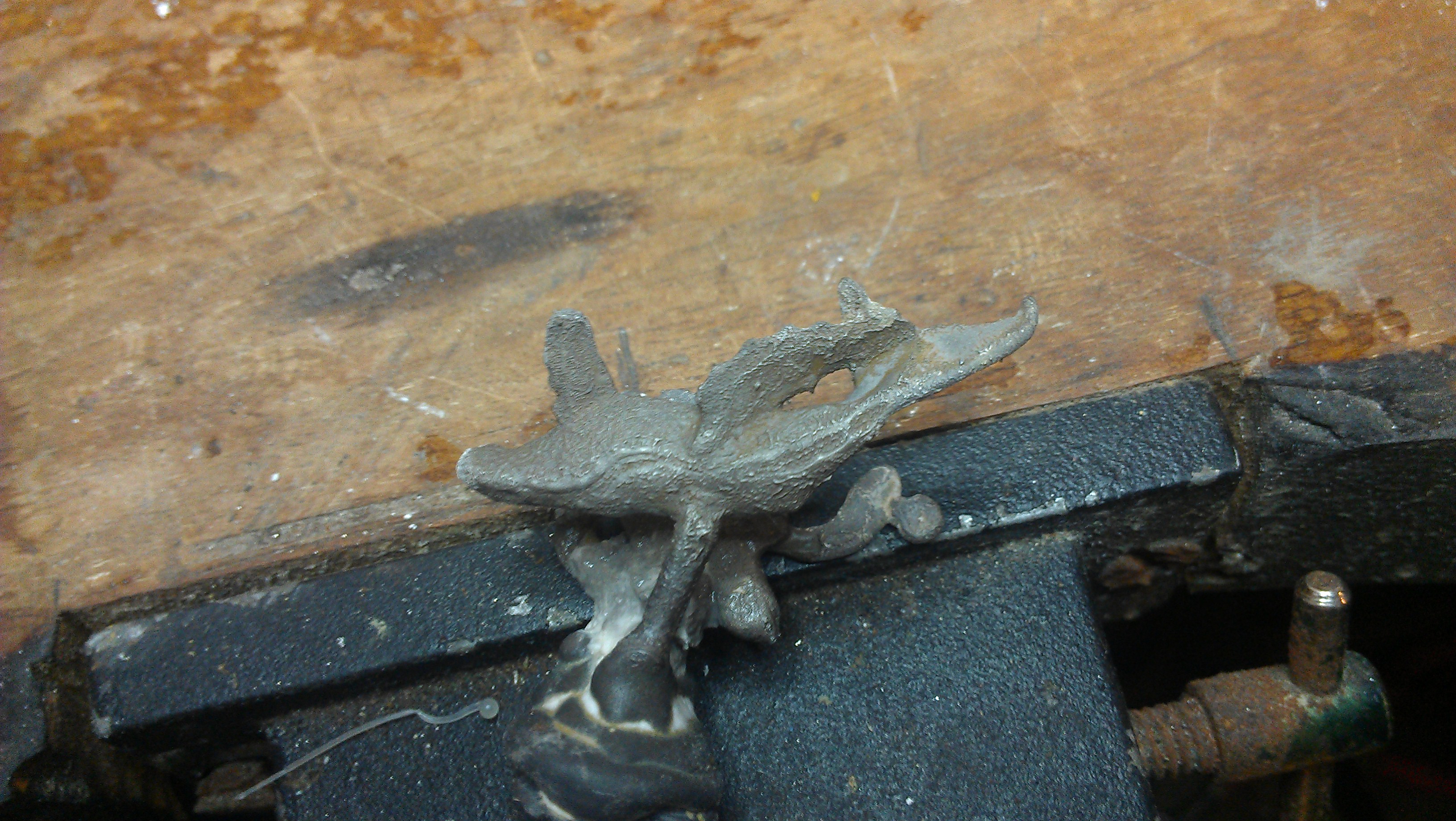

Hello everyone,
I was curious about using green soap tincture to reduce surface
tension on wax models so I dipped my wax models just before filling
the flask and it went pretty badly.
After casting there was a very black and crusty-distorted surface.
After this disaster, I checked the bottle and it says "Green Soap,
and Ethyl alcohol 30%… purified water, and my current suspect.
lavender oil.
So was it the lavender oil that did not burn out and I assume there
are green soap tinctures that are pure without the lavender oil? I
didn’t have much bubbles to begin with on my castings so far so I
may just abandon this idea unless someone can share what brand they
use. Or do people make their own?
I did a standard 5 hour burn out for a small flask.
The brand is called “Cosco” and it seemed to be very basic green
soap for hospital cleaning. I wish they put the words “scented” on
there so I would have known it was not pure green soap.
Thanks,
Rick
there are green soap tinctures that are pure without the lavender
oil?
I doubt it was the lavender oil, because I use it in vitreous enamel
painting and it burns out cleanly.
A guess, from your picture, is that there was a residual soap left
over with a investment mixture that has to much gloss over time.
This can result in water separation.
Also your piece is too black, suggesting to a low temp burnout or to
a short time.
I should be white after casting.
A vacuum machine will solve all those problems.

The other issue could be that investment, if not mixed up near the
time of gloss off (8minutes ish) will sperate back to solid and
water. I didn’t look at the pic before, it looks more like the water
streaks I get if I rush the process and the flask sat too long
before it sets up. Need to be mixed more near to time of pouring. Use
some debubbleizer and you should be good. It is a bit dark as someone
mentioned which is to short a time or insufficient temp. Good luck
