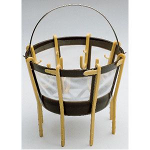

Has anyone tried the stuller basket 23-2000

I’ve been using one for years. Not the same one mind you, but the
same style. They eventually get a hole in the mesh and I need to
replace it. They work great.
