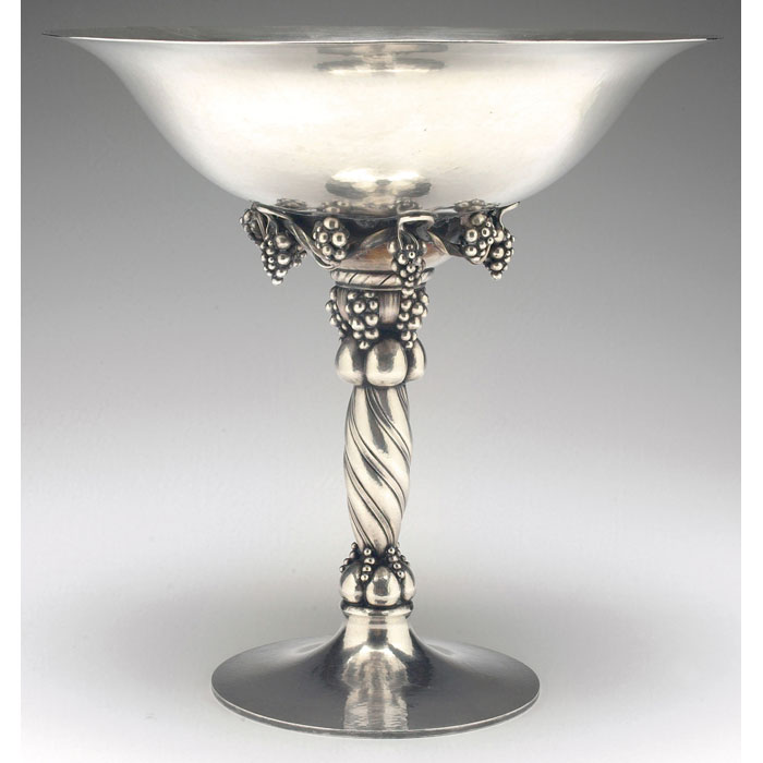

Hello,
Does anyone have experience using this particular torch and tips:
http://www.ganoksin.com/gnkurl/rio500601
for brazing heavier pieces, such as reattaching a grape cluster to a
compote: http://www.ganoksin.com/ftp/0475.jpg
Does the torch put out enough BTUs?
Many thanks,
Jeffrey Herman

Hello all,
Thank you for your recommendations. What I should have mentioned, as
I did in previous posts, is that I want to stay away from
oxy-acetylene because I don’t like brazing with shaded glasses. I had
a Smith oxy-acetylene torch years ago and sold it for this reason. I
currently use natural gas an compressed air.
Maybe I’m looking for a torch that simply doesn’t exist.
Jeff Herman
