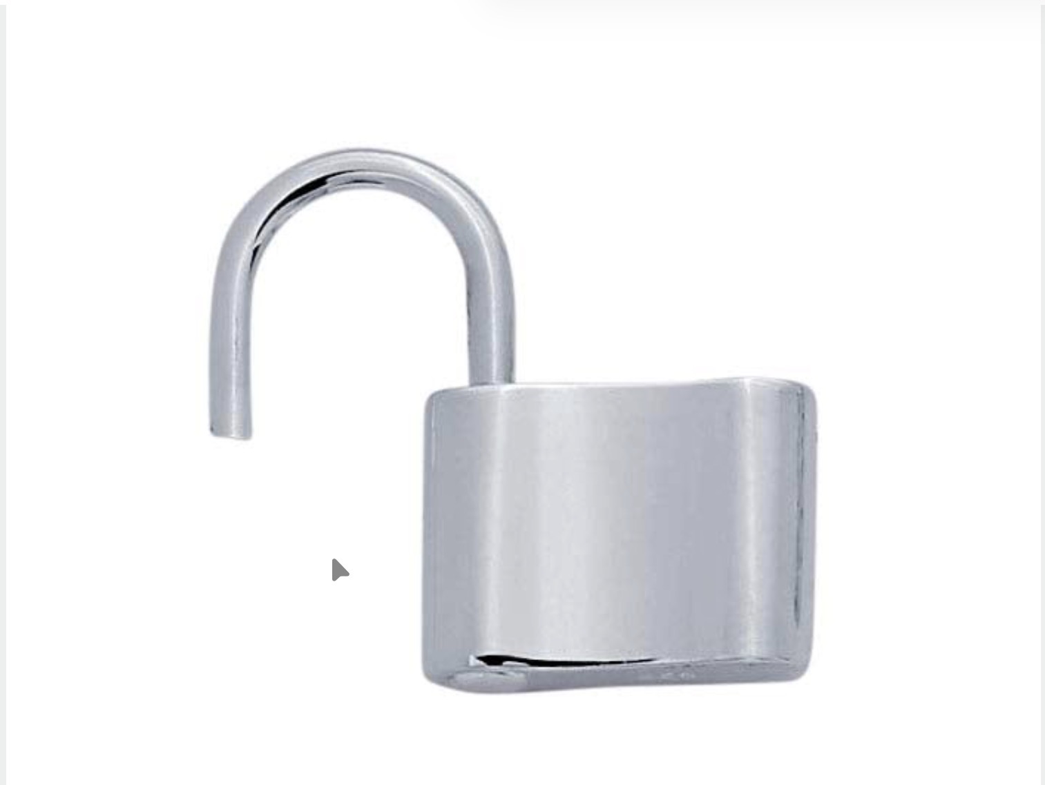

The padlock clasp is quite literally a padlock in design , there is a button on the bottom that causes the spring loaded mechanism to release the padlock like clasp. Pretty cool.
Could you provide a picture of the clasp, it would help see how it works.

Padlock clasp in all of its glory
I want to solder the jump ring on the bottom next to the button
