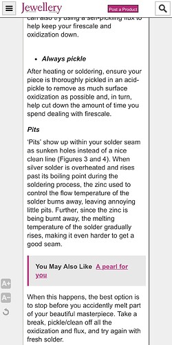

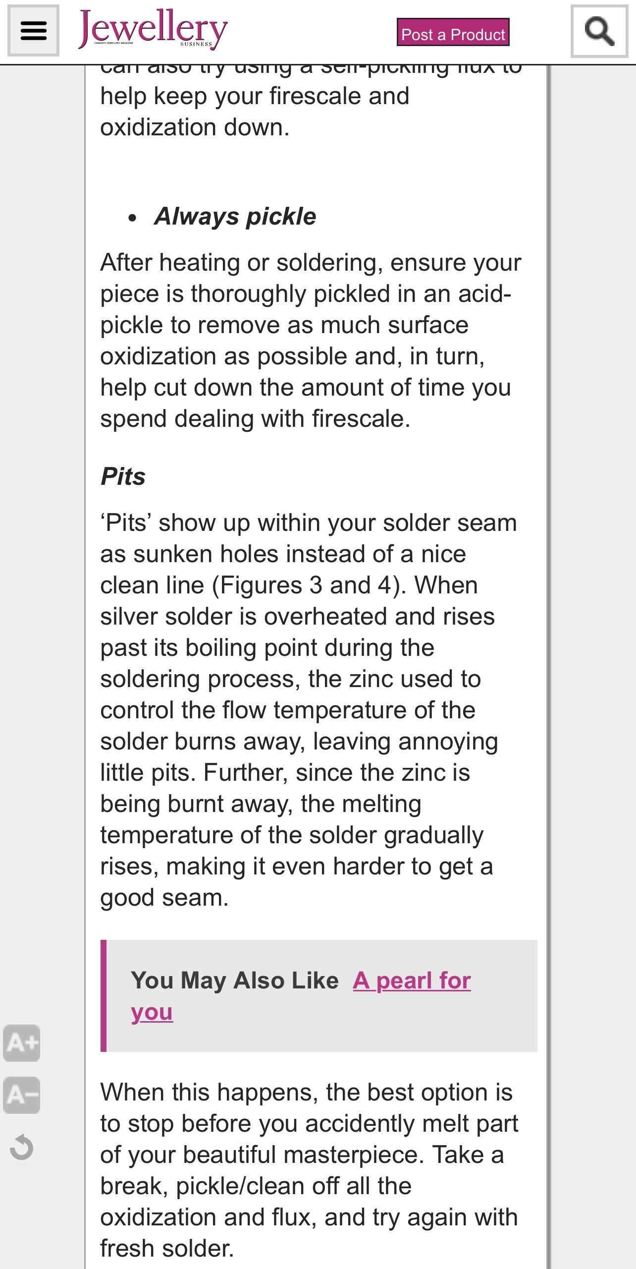

Hi,
some thoughts…correct me if i am wrong…i believe the pitting occurs as a result of overheating…the zinc in the solder reaching boiling point and vaporizing…
zinc melting point -788F
zinc boiling point- 1665F
silver solder melting points are around 1325F-1450F
copper in the alloy reduces the melting temp of the individual elements
zinc in the alloy improves flow
