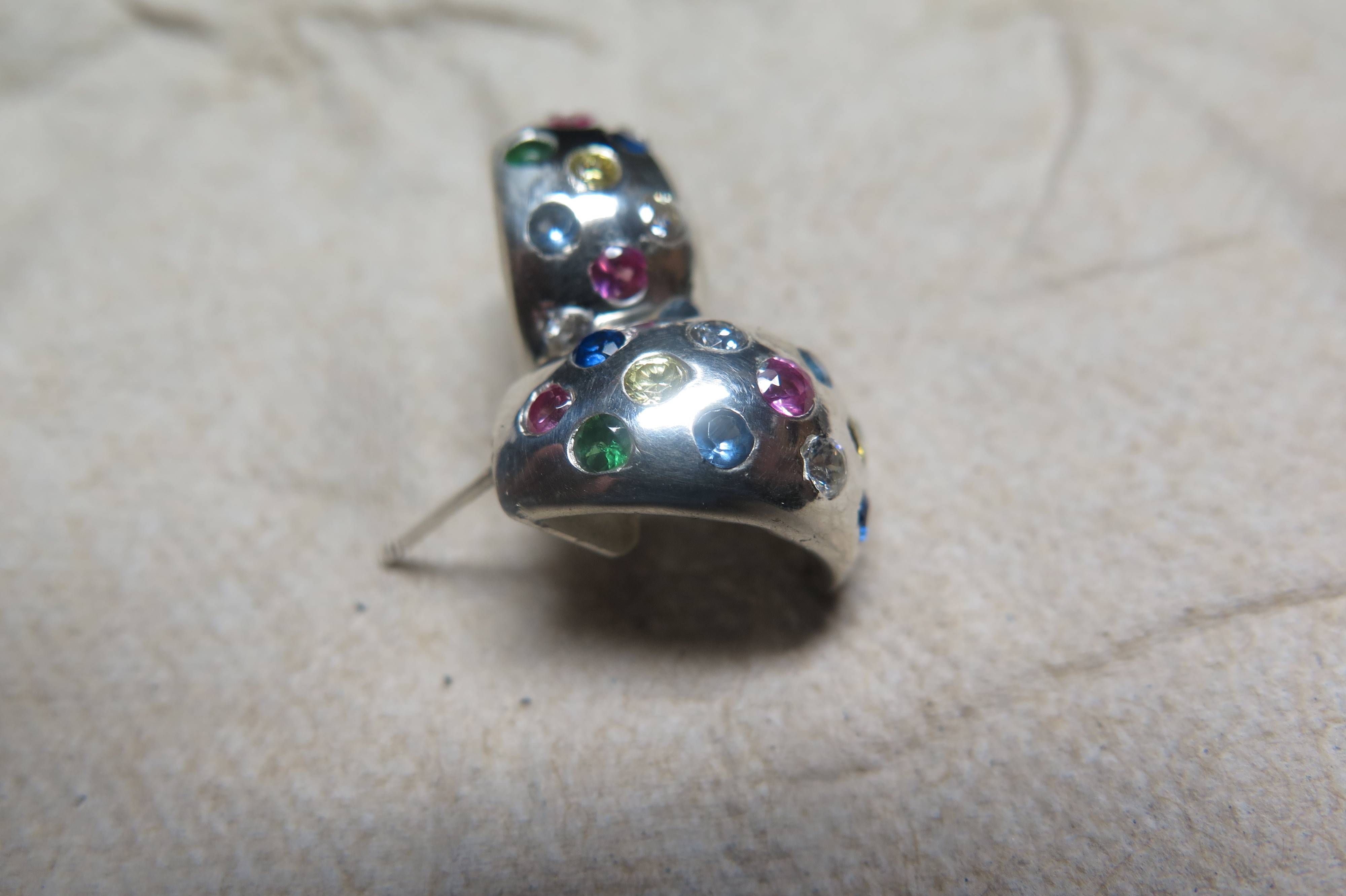

Normally, and I mean normally Gypsy/Flush setting is one of the safest methods in setting a stone. If the stone fell out there are reasons why this did happen. The stone was not lowered into the hole enough to literally ‘grab’ all of the “Crown Facets” or the Girdle. If any Bright-Cutting was attempted, I suppose too much metal was removed in this singular process. BTW, the ‘table’ of the stone must be flush (or even lower) with the surrounding metal, if not the stone will for sure indeed pop-out!!!
What you are looking at ( in this photograph) is an incomplete setting, the finishing in cleaning has not occurred at this time.
When I am teaching this process, I use (.925) silver at all times, please do not get discouraged with this easy-to-use metal…another point is that the girdle of the stone MUST be much lower and this is to allow for hammering (as shown) and using a pumice wheel.

These two silver items were set with the “Set-In-The-Wax” process. These looked easy & they were even much easier to set. Each stone took me about 10 seconds to place into the wax item. If I set by hand hand, each ring would take me about one hour, why so long? I had to gauge the depth, secure one stone (at a time) then so lightly hammer the metal over the girdle of that stone…(but not finish) then go to another of the 12 stones, with 13 stones in each item. Setting all stones in wax took me about maximum 2-3 minutes, I had to be very sure none of the stones went too deep into the soft wax!!!
All of these stones were “Swarovski” CZ’s & had a 8.75+ on the “Moh’s Scale of Hardness”. After all of the stones were secured & hammered I cleaned up everywhere with a flat-faced, Pumice Wheel of #180 grit. I had to make darn sure the ‘double-axis’ of curves were kept…that is in the length & width. Not too mention that I used the graver to cut around the stone/metal, but not too much as to remove any of the precious metal holding the stone as this is a very delicate manoeuvre. Setting this style of rings is not easy in metal, that is just why I chose to work in the wax system. Loads easier & faster!!!
