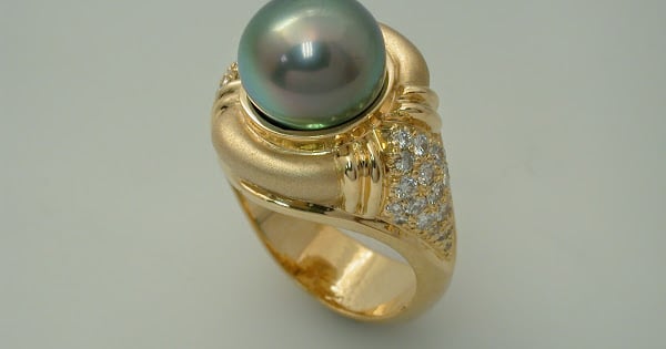

I like the contrast between the brightly polish areas and the sandblasted areas and would sometime use in some of my designs, as can be seen in this ring for my wife.
Google Photos
Because the sandblasting, and the medium I use, is such a fine texture, it tends to ware quicker, so I would usually use a heavier texture with my designs.
