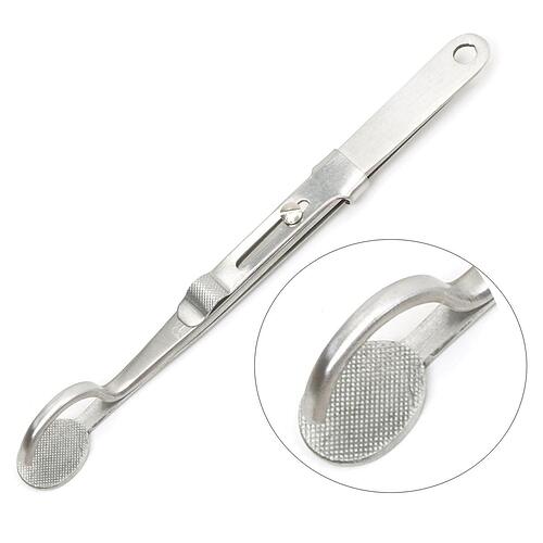

Lots of great advice for filing the connection. This isn’t exactly what you asked, but is a tool that I find to be very helpful in making this kind of connection. They’re special tweezers for soldering settings onto rings. If the bezel is bigger than the flat part of tweezers then I use a coin or a non-galvanized steel washer to make it bigger. I’ve nicknamed these tweezers, “the magic tweezers” because you can easily check alignment before soldering. I use them whenever I can for a connection like this one. Most jewelry tool companies sell this style of tweezer.
Jeff
I have a pair of those and LOVE them.
