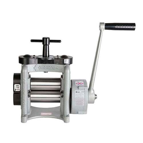

Fyi the Durston Agile F130 is now available at Rio for $849. I really thought it would be price comparable to the Pepe line based on what was said above, but what do I know.
Can anyone offer a fair comparison to the Pepe spec-wise, other than the added 5-1 reduc gears?

For the AGILE F130 the obvious is, as you say the 5 -1 gearbox.
Then of course you have a Durston. - which is like no other piece of equipment for holding its value,
If you decide to sell it in 30 years time you may get what you paid for it.
For the Agile C130, There are 11 square grooves, 60mm of flat and 5 half rounds on the roll.
and of course the 5-1 gearbox.
The price is very good and I did hear that Rio Grande may have these on a special price on Monday.
Please let me know if you have any questions.

Hi Matthew. I am curious about the strength of the DRM F130 and the Agile F130.
Can I get a deeper texture from a roller plate using the DRM F130 vs the Agile F130?
Is the DRM more powerful? or easier to use?
The specs seem to be the same except for the weight and the handle or wheel on the top.
Thank you so much.
