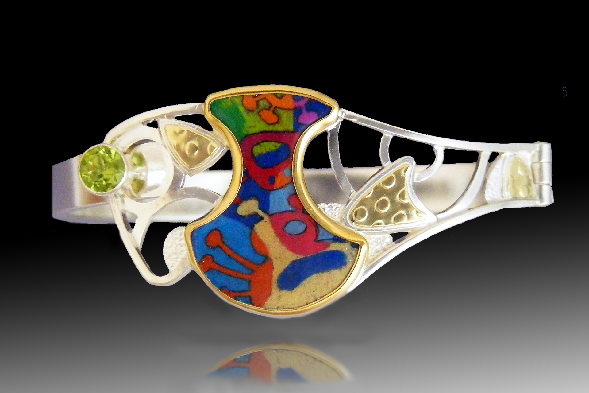

Materials: sterling silver, 18 & 22k gold, prismacolor pencil and ink drawing on polymer, peridot
Dimensions: 7" L X 1.8"H
Bracelet: fabricated; sterling silver, 18k & 22k gold, peridot, Cabachon made from original prismacolor pencil and ink drawing on polymer capped with an automotive enamel
Photo credit: Wendy Newman
Wendy Newman
Wendy Newman Jewelry
Moab, UT. USA
After 10 years of research, I have developed a technique that incorporates the embedding of color on recycled plastics. This method transfers my hand drawn prismacolor pencil and ink images permanently into the polymers and creates cabochons which I cap with an automotive enamel and bezel set in 22k gold.
Coming from a graphic arts and sign painting background, I use Jetson's- era imagery combined with elements from signs and typefaces. I cut out each piece of trim from hand-rolled and textured 18k gold sheet, solder it to a silver base, do another layer of "piercing" with a jewelers saw, then finally hand-texture and polish it. Also, many of the pieces from this series are fabricated from sterling silver flat wire using traditional bending and hammering techniques.
After receiving a BFA in crafts (jewelry design) from VCU in 1981, I have made a living selling my work at fine art shows and in galleries. I also worked for about 15 years as a bench jeweler.
