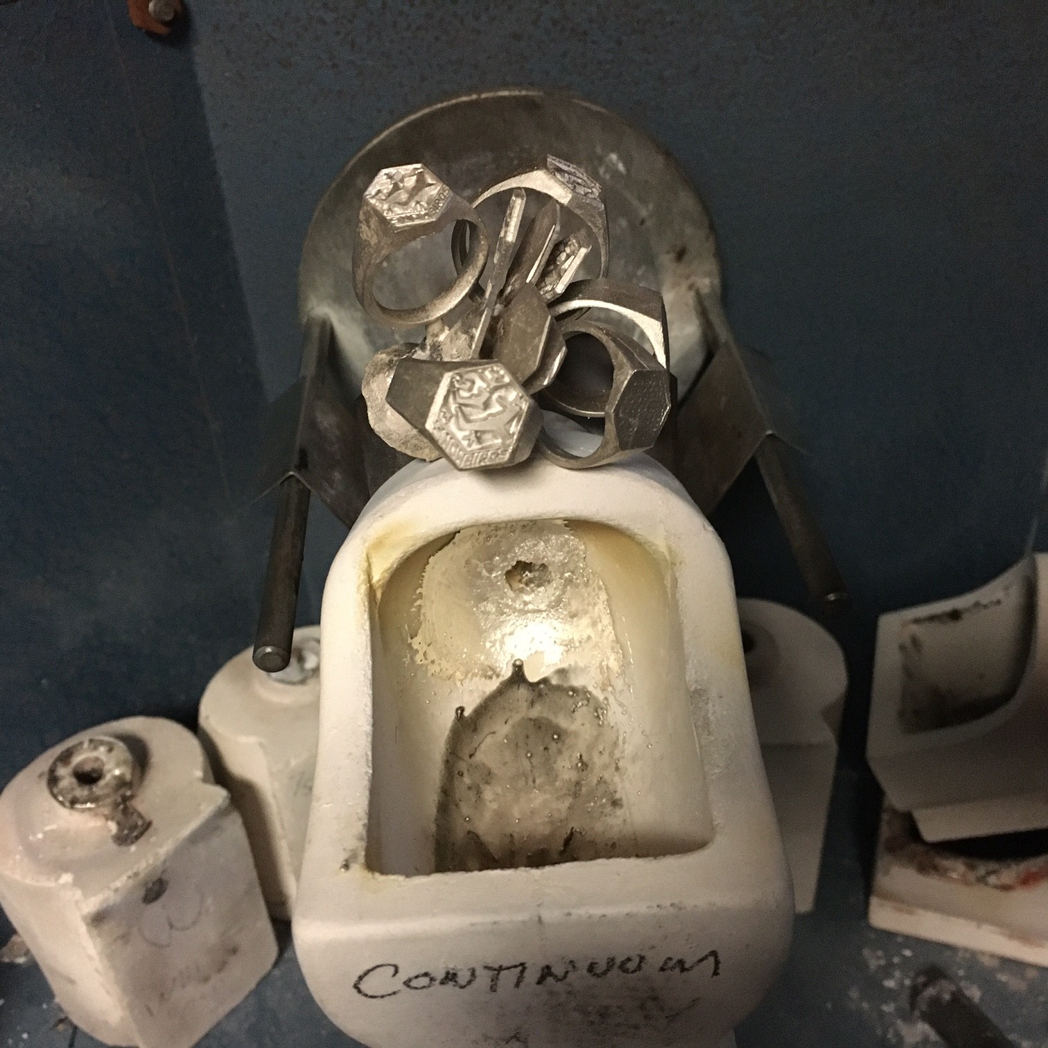

This evening I attempted my first centrifugal casting (as per your directions, got a brand new crucible and used a new quartz stir rod with standard borax flux. I was impressed with how silky the melt was, using my old acetylene torch… That went nicely. The casting was quenched when close to 800 but not sure but I do have an accurate kiln to re-temper if needed. Pieces are pickling currently, so will post a followup after working on those items.

Followup
This is my 1st casting of Continuum / So far I love the stuff and am amazed at how much like gold it feels and works. The melt with my acetylene torch was slick and fast considering I tossed my entire 90 grams into the new crucible. Filing and finishing has been excellent and less signs of porosity on the castings than most other metals I use.

For some reason I am really getting thick oxides on the cast pieces of Continuum… Really love the metal but massive finishing is needed to clean the surfaces
Just finished this ring with rose cut diamonds. It went really well up until the finishing
What sort of thick oxides? More details please on the finishing issues. How did you cast it? Did you use borax when casting? Did you use a carbon stir rod? Did you quench while hot? Did you pickle it afterwards?
Jo
Standard casting method (cast using acetylene) … Small piece cast in a steel adjustable ingot mold… Yes I used borax flux … stirred using a quartz rod . I rolled out the ingot and hammered it into the design , so was annealed and quenched several times . The oxides are very similar to the stubborn ster alloy oxides that have tormented me for years. Perhaps its just a special talent of mine …
Creating surface oxides! My next theory is to use Hydrogen Peroxide in the pickle like I use on white gold (might work)
What kind of crucible are you using?
Standard Crucibles The only new one I have here sitting in a box (as far as knowing brand) is a procraft by Grobet … High temp porcelain type crucible… Not sure what material these are? Not much help… sorry
