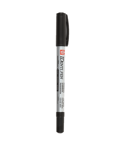

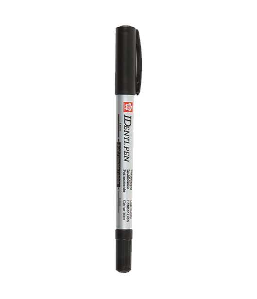

Sakura also makes a super fine point waterproof marker that is finer than the extra fine Sharpie.
