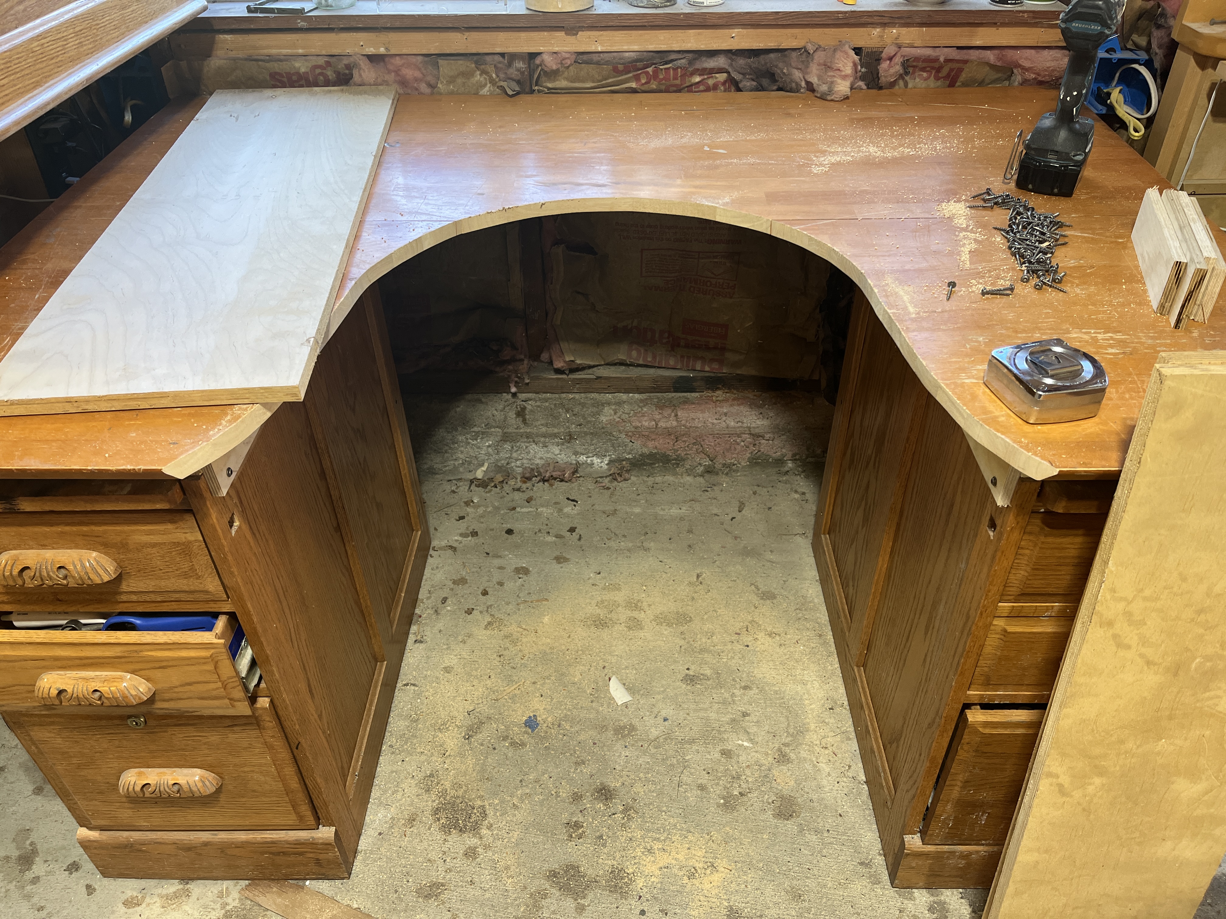

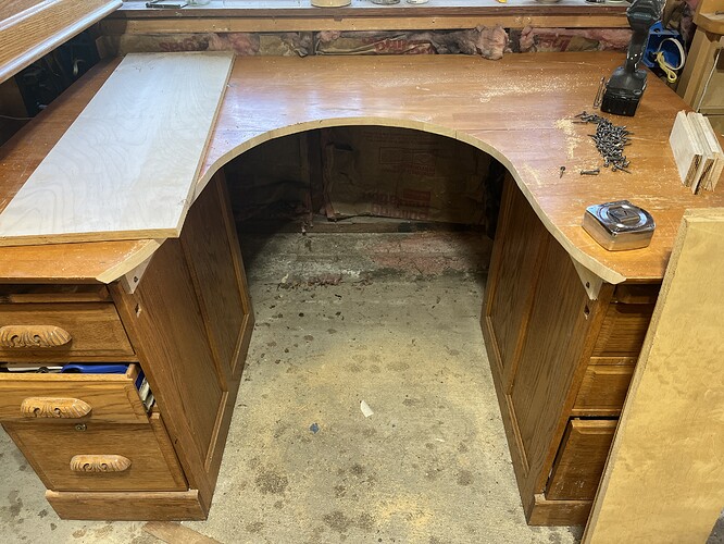

Small update:
I found a large dining table on the side of the road and it joins the growing and adapting frankenbench.
I put the large dining table on the filing cabinet/drawers that originally came with the roll top desk. Then I cut out a matching shape to match the roll top desk cutout, used scrap 2x6 to space the two desks, and slid the roll top desk over.
We’ll see if it needs to be spaced up higher. I’m guessing another inch might help. Heh.
Next I’ll reinstall the filings tray and I might update it to a skin.
Cheers!

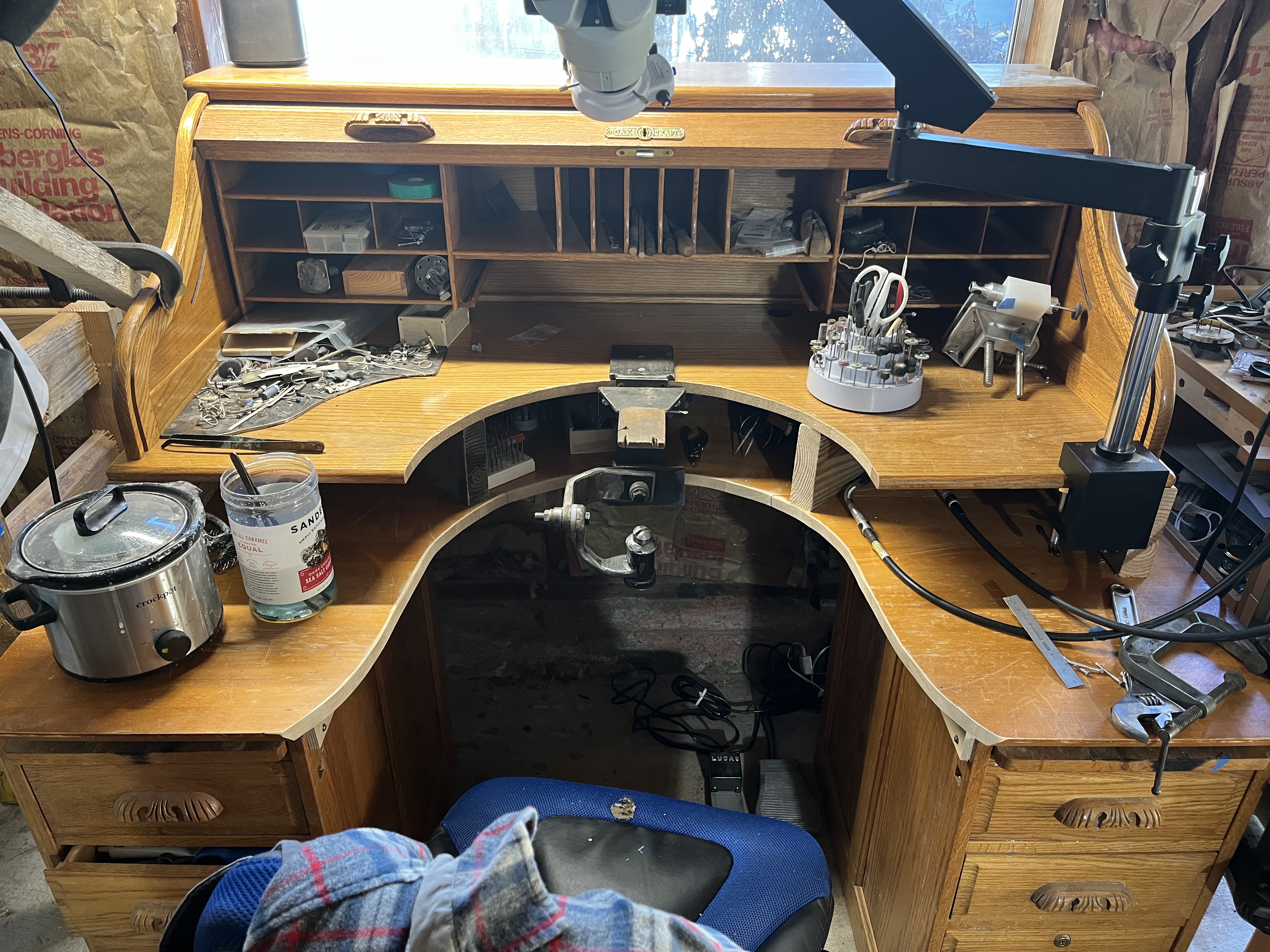

Here’s a pic with a stop gap filings drawer made from plywood so I can keep working looks with me in it.
I’ve got a soldering station on a pull out work surface on my right going too.
