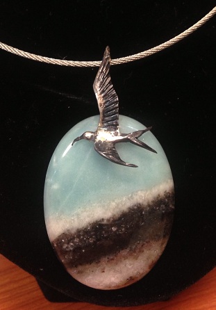

You can also plate the steel with Legor’s nano ceramic electro
plating but getting the equipment is not cheep. It will protect it
from rusting for years of normal wear. Here is a fright bird piece I
did in Steel with silver accents it is 3 years old.
