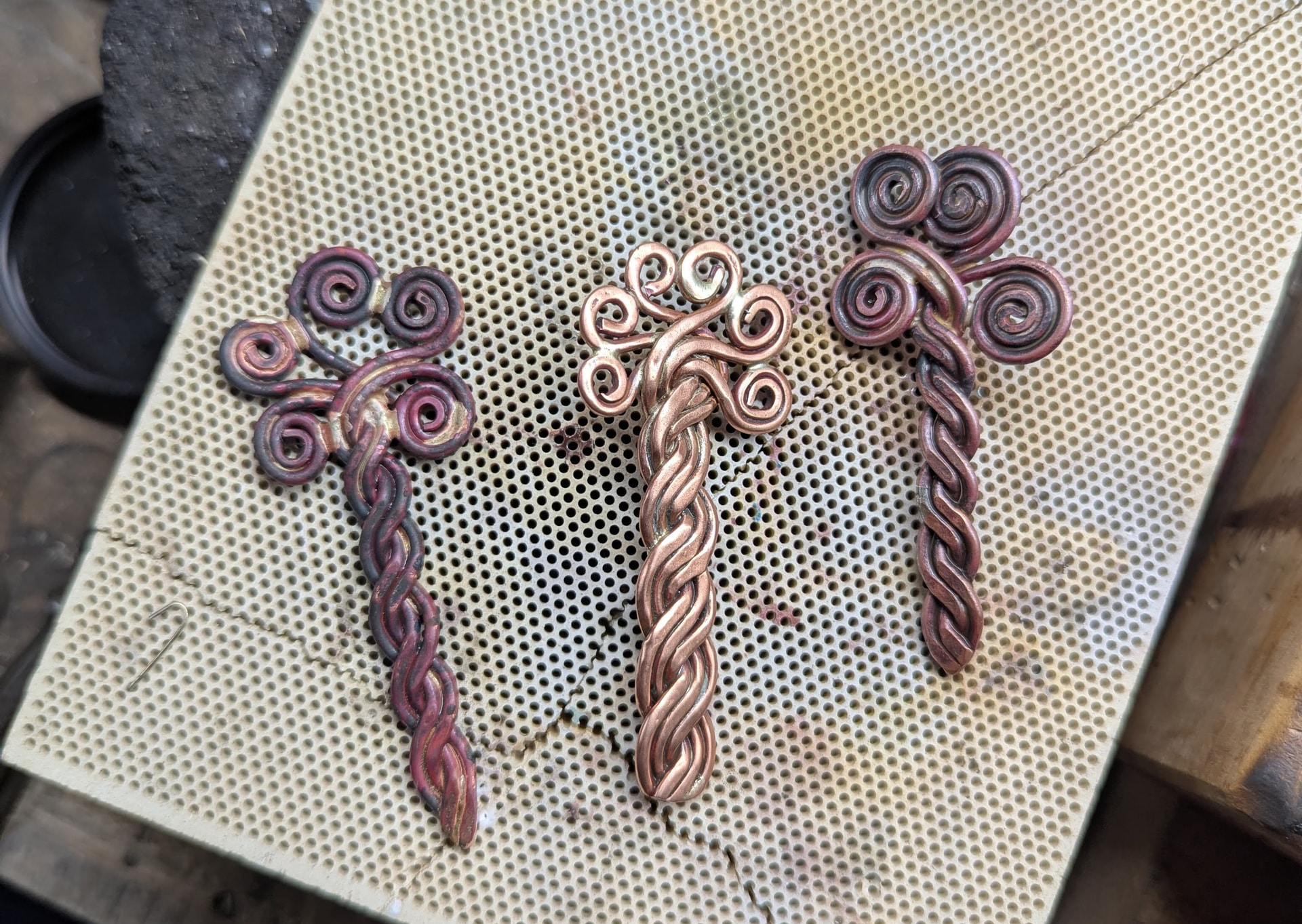

Here are some Celtic style pendants underway.
More news when I have it. Don

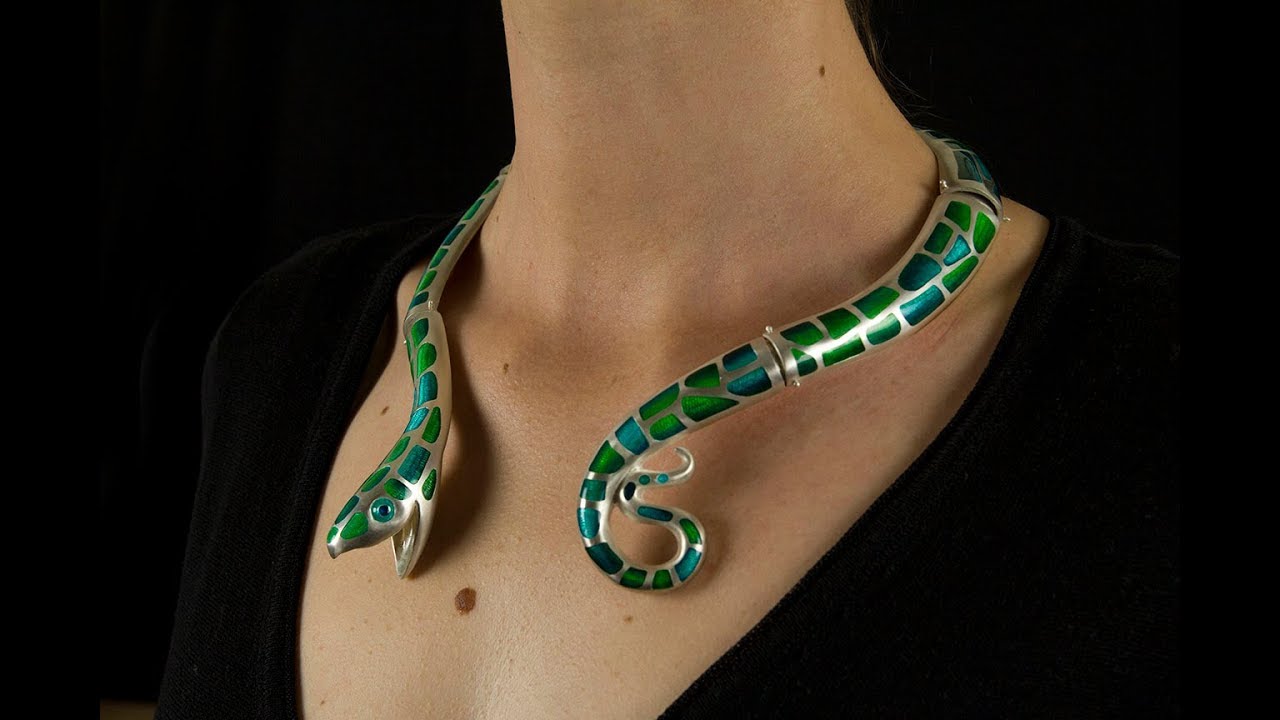

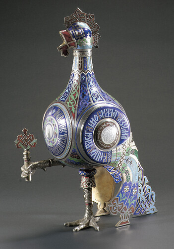

Here are a few selected links that provided me with inspiration. I hope you enjoy them as much as I did…
Thanks for sharing these. They are pretty amazing…Rob
Hello Greg! Thank you for responding. I love these video’s! Your skills are incredible. Your art work is some of the most beautiful and creative peice’s I’ve ever seen! And your story was so moving. I love hearing the stories of creator’s, they can be so motivational. You have definitely sparked my will to learn more. And step out of my comfort zone. You have motivated me to challenge my abilities. My abilities are top end of beginner to bottom of intermediate. I’m feeling so excited to jump down the rabbit hole of Plique-a-joure! I’ve been feeling stuck, creatively, but now a spark from you, has created a fire of inspiration under me! Those peices of Plique-a-joure you featured, were just breathtaking! So again, thank you for sharing and thank you for the inspiration!!! Many blessings!:sparkles:
Hi Tammie!
I’m very sorry if my post caused a misunderstanding. NONE of these links are to any of my personal work. They are instead links to works of other jewelers whose incredible talent inspired me to strive to attain a higher level of excellence.
Whenever I find myself in a rut and in desperate need of a kick in the pants to reboot my creativity engine, I go look at the incredible work of talented artists like these.
I’m delighted to know they also provided inspiration to others, because that was my hope when sharing these links…
Greg
