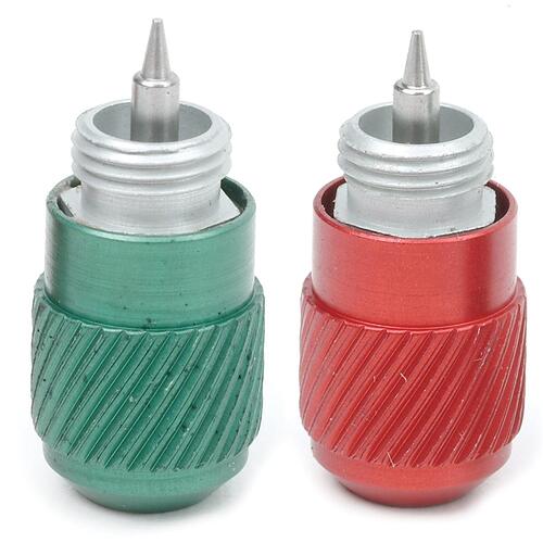

It appears that I am having torch problems all around. My EZ Torch leaks propane at the handle shut off. There isn’t much to it and I can replace the entire handle for less than $100, but I am looking first for parts. They don’t seem to be available at the usual places. If anyone knows where I can buy the shut off stem let me know. Thanks…Rob

I think this is what you’re asking for right? I know that Otto Frei sells them. I don’t know about other jewelry tool companies? Actually, now that I think about it. Miller Welding bought out Smith and now makes the Little Torch. I’m pretty sure that means that most any welding supply company can order them for you.
It’s been a while since I’ve taken one of these torches apart, but as far as I remember these valves fit into a delrin plastic valve hole (I’m not sure what that would be called?). It could be that the delrin plastic hole that these valves fit into is damaged.
Also, each valve is $52.30 each on sale. That’s over $100 for a pair. I hate through-away culture, but if you can get a new handpiece for $100 it might be your best bet?
Jeff
Jeff…Thanks, but it is my EZ Torch that is giving me trouble. I bought a new Little Torch last year to replace the one that was bought probably 40 years ago…Rob

Most jewelry tool companies have repair departments. It wouldn’t hurt to send an email to wherever you bought the torch from or your favorite jewelry tool company and ask them for advice. It may be that there are replacement parts available to distributors that aren’t available elsewhere.
Let me know what happens. I’ve got an EZ torch too.
Jeff
Jeff…It is not unusual for me to misread something, especially early without coffee. I will give Otto Frei a call later when they are open. I can replace the whole handle for $60 and that is what I may do. It is also chipped from being dropped. Thanks…Rob
