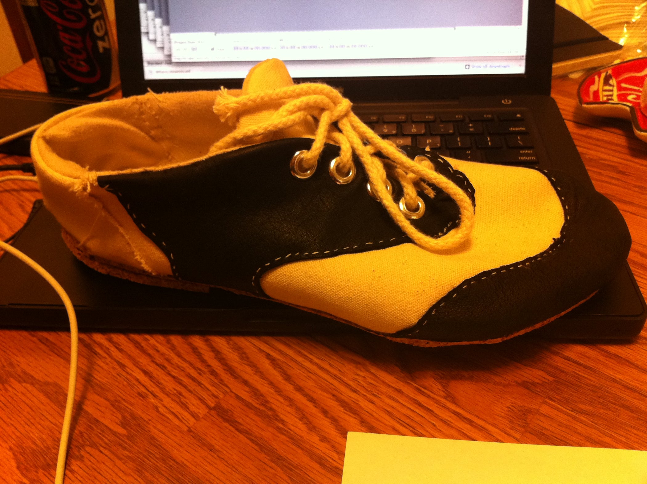

Jo and Helen both, I guess. I was going to be sly and paste some
page. Googling “making shoes” brought up too many hits to paste,
though. How-to’s, classes, books. The link below is on top and goes
step by step, though the sample picture is awfully funky:
