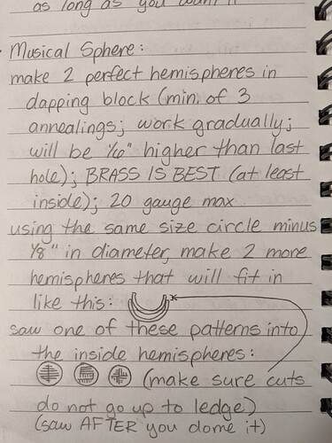

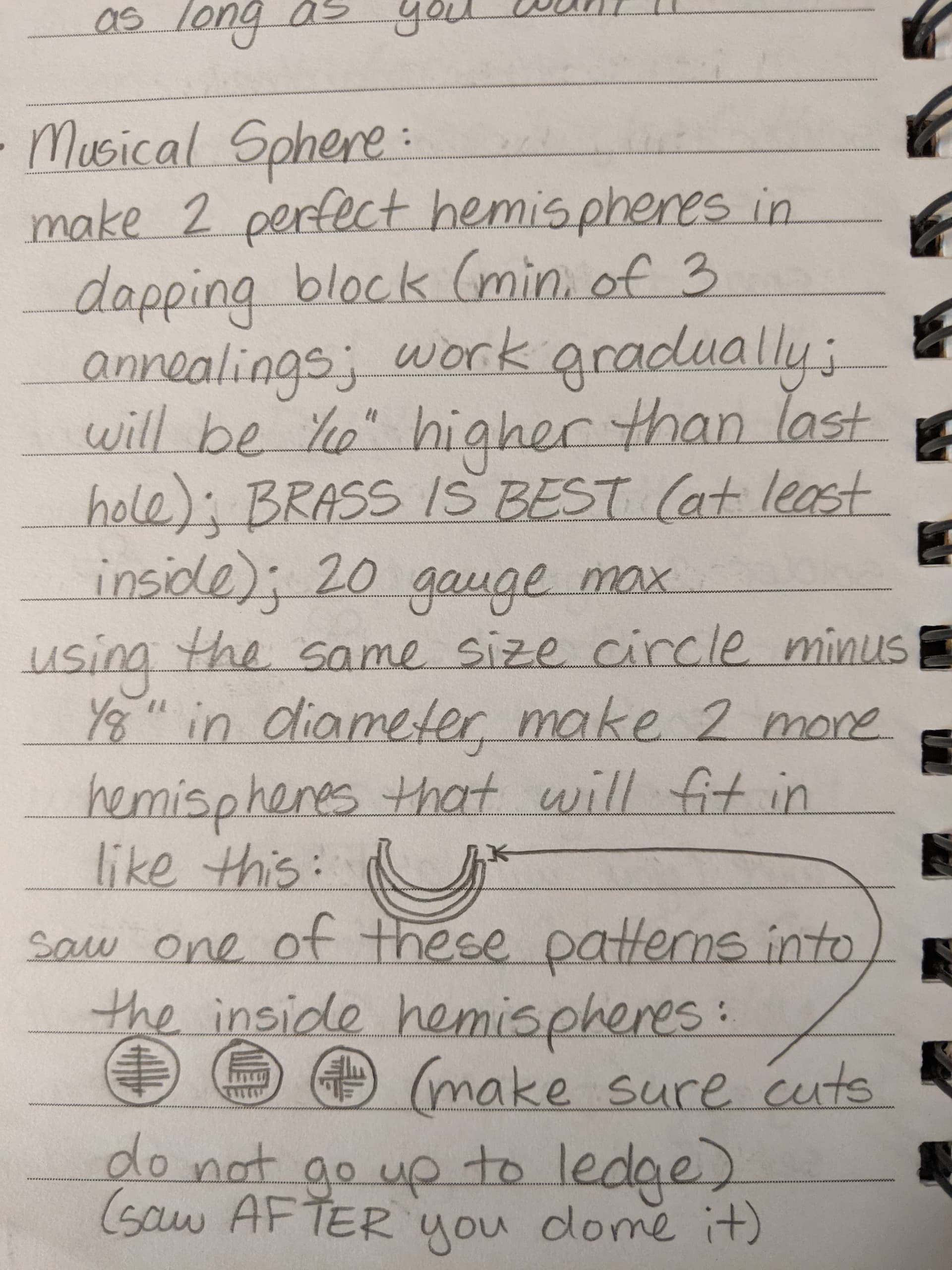

For a more impressive sound, make the outside ball at least 2 1/2"
to 3" in diameter. The inside sound board is made by shallow doming
2 discs of very thin (but sturdy) brass (hardware or craft store).
Saw multiple slots across each brass dome, cutting nearly to the
rim. Solder each brass dome at the rim to the inside of each of the
larger outside domes. The inside brass should only touch the outside
dome at the rim. Add one or more steel ball bearings (hardware
store). Drill a small air hole in the outside dome. Solder the
outside domes together. Before pickling, place a wire into the air
hole and solder it shut.
Nancy

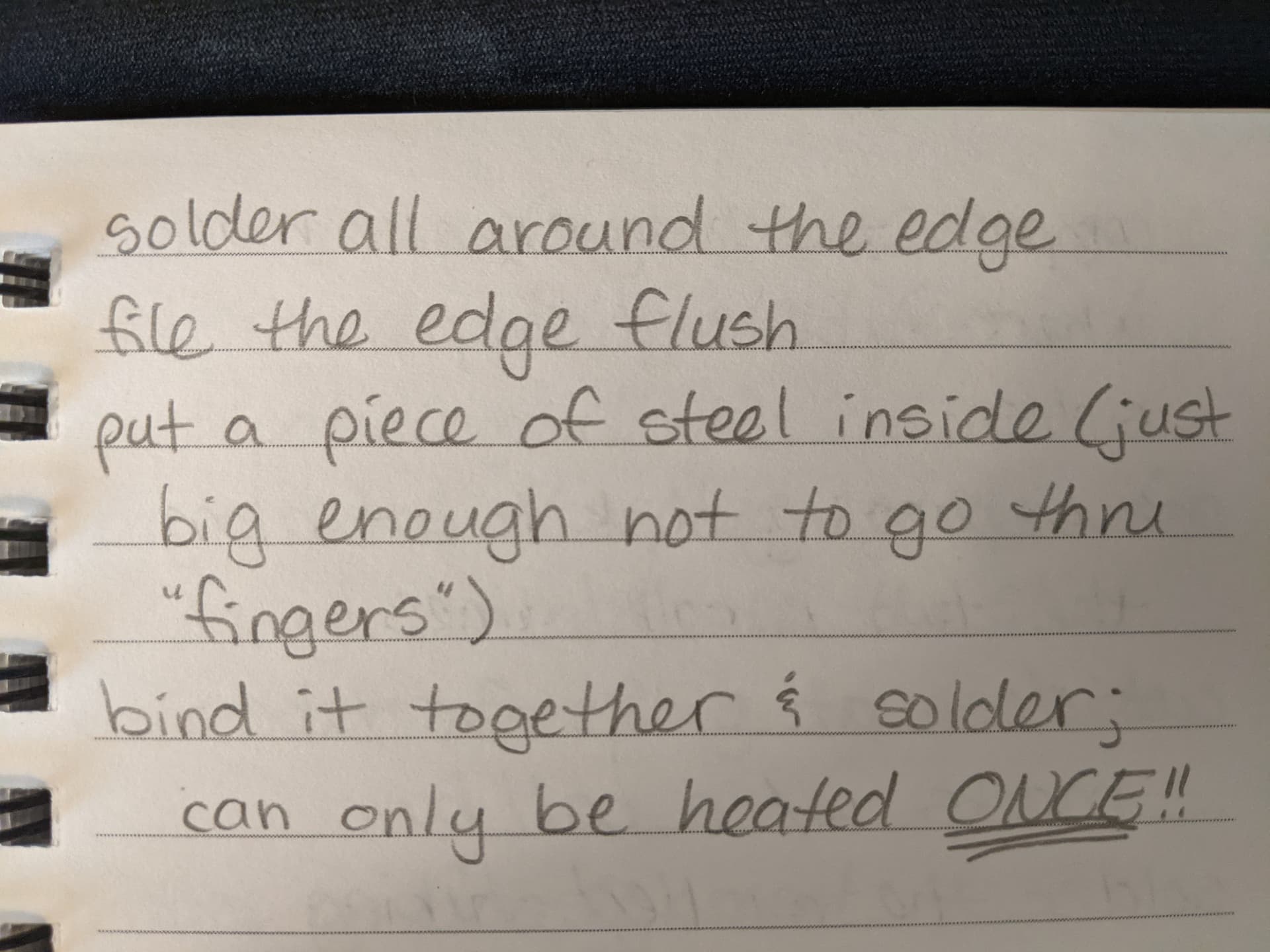

I sent you a private e-mail, but in case anybody else is wondering on
this - I have notes and sketches from when we had a visiting artist
during my undergrad studies who did a demo on this, and would be
happy to scan them and send them to anyone interested.
Jen
http://www.jmwjewelry.com
Hi Jen, I would really like to see those notes and sketches, could
you send them to orchid please? Thanks a billion.
For anyone who wants my notes mentioned above (I don’t have access to my old account anymore), here you go!
This is pretty late to the party, but I have a few questions. What did you make your harmony balls with? Was the outer shell silver with the inner dished fingers in brass? Did you also try making all silver harmony balls? Is there a problem with annealing the fingers? If the ball is shaken, will the fingers move and lose their springy ability to chime if you use silver for the fingers? Did you use different temperature solders for the various steps? For instance, did you use hard or medium solder to attach the dished fingers to the outer hemispheres, file them flush, bind them together with ball bearings inserted and then solder with soft solder? Or did you use a higher or same temperature solder throughout the process? Thanks much for any additional information. Best, Donna
