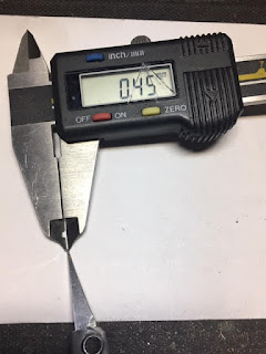

The Flat graver cutting face is also reshaped to be now 0.45 mm’s, why so thin? It has to cut in between a narrow allotted space. I want that graver to cut only where it is needed and not ruining the whole effect!!!
Now you can see the thin cutting face. I could even make it thinner if I choose to during the precise cutting stages.

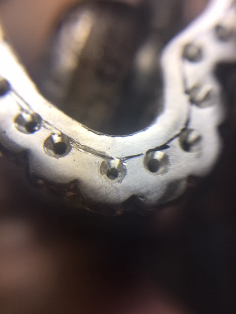

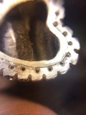

For all the cutting that I do, is to prepare a line (as a guide) in ink. This is where the line-cutting starts.
The very first cut is SO IMPORTANT, this cannot be overlooked. I’ll be cutting a line just at the ‘rim’ of each hole. Compare this photograph from another recent essay I wrote a few days ago.
Now please compare that picture to what I’m showing you now and the following photographs!
The line-cutting was not against the edge of the hole! These “results speak for themselves”.

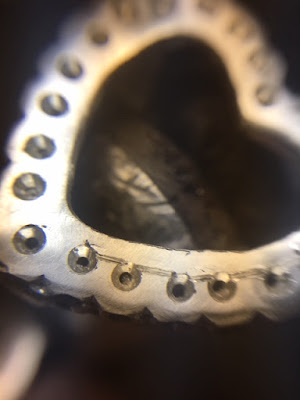

One hole was not in line with the others, this will give me a little challenge, what am I to do?
I’d first have the round bur lean/move as it’s rotating on one side towards and closer to the rest of the stones. No big deal, but this takes some serious and careful drilling.
When done, I’ll just continue on with the line-cutting right through the original edge of the hole. Remember that we’re only dealing with (maybe) 1millimetre, just don’t worry!
YES, cutting against a curve is somewhat of a challenge. What I do is to take shorter graver cuts and slowly cut around the curve.
Just go slowly , and with much care in using your modified Onglette #1 graver. I could take three cuts in the metal to traverse each of the two holes.
If you fail in cutting at the edge, problems will lay ahead and the final effect will not be what you desire!
Now the heart-shaped pattern is starting to take place. Although it’s only in its infancy, I can see where this is taking me & us!
With your greatly modified, ultra-thin graver, start another stage in cutting. From in between each of the two holes cut into each hole as shown.
The result is a little triangle or “Vee” shape configuration. These two cuts will eventually be your new beads!!!

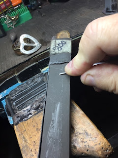

KEEP YOUR FLAT-GRAVER sharp & highly polished by using #800 or #1,200 Polishing paper.

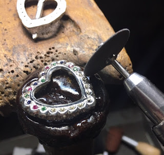

You can see just where the filing is taking place, gentle twisting around the curved spots. After this, you can use your Pumice wheels to smooth the ‘filing stirations’.
In these two photographs, you can see just where the Pumice wheels are being used and which in
sequence. I’ll tell you first, use your Pumice wheel #240 grit then following with a Pumice #1,000 grits. The second wheel almost polishes all of the markings, as the cloth-wheel on your polishing where just buffs everything but not in those little areas.

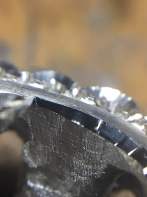

Now, what are we going to do? My suggestion is to reduce the ‘vacant areas’ from the inside edge to the Bright-Cut sections. We’re going to be using a wide Flat-Cutting #40 Graver, simple as that!!!
Please make sure that your Flat Graver #40 has a sharp edge for cutting into metal and not leaving any stirations…as seen in this picture. This cut being shown is almost acceptable!
Ah-h, this newer cut now has a very clean cut. I’m cutting at a very wide angle, enough to remove all of that ‘unnecessary’ metal in just one cut!!! I think the Flat graver is now at a 45degree angle.
This is just the kind of Onglette cut that I’m now looking for, no cutting marks. I’m actually digging into the metal aggressively!
This is another view of the long cuts that I’m interested in.
This will be now the final cutting on the inside area. You can see the angle of the graver doing the last finishing cut!

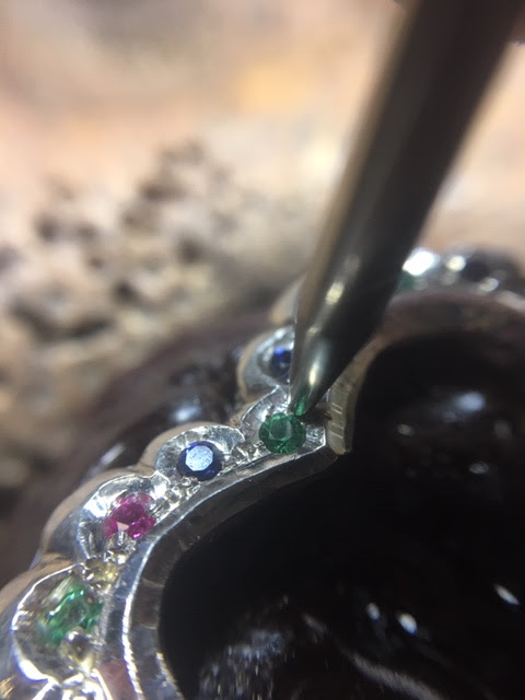

For setting delicate Emeralds, “just tread lightly” with your bead-burnisher. I’m using for this example a #12 burnishing tool .
Hold your burnisher at a greater angle away from the facets, so the tool won’t touch the stone!!!
In this up close photograph, you can see just where the 156C undercutting is situated. This bur is now making a ‘seat’ for the stone and as well as preparing a groove in & against the new bead!
With the stone nicely sitting in the metal, its time now to push over the new bead. This can be accomplished so easily, all it takes now is your bead-burnisher to literally move the little bead up and of course, over the stone.
