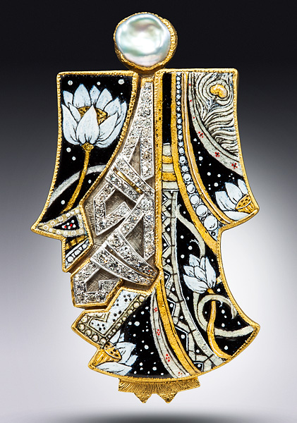

Materials: Grisaille Enamel w/24kt & .999 Silver Foils Pearl Antique Diamond & Platinum Ap 1.25ct Diamond, 24K•14K Yellow, Argentium Silver Fabricated & Engraved
Dimensions: 2 3/4" x 1 3/8" x 1/4"
Kabuki Kachina
Steps softly into
Starlight
The heavens swirl
All is still
But the symphony
Of night
Marianne Hunter
Hunter Studios
Palos Verdes, CA. USA
My enamel technique begins with 3-5 background firings of black enamel over copper or silver. The images are then built up in multiple firings of very thin layers of enamels which are applied dry by sifting or by laying on with a tiny knife. My grisaille process utilizes very fine mesh white enamel over the black for a full range of value: black to grey to white. When I am using color I most often use precisely cut 24 K and.999 silver foils, each tiny shape from the drawing. As needed, they are carefully placed and fired over the previously fired and cooled layers. A delicate layer of transparent and/or opalescent enamels is then laid and fired. Additional layers of foils and enamels are built up until the full range and depth of color and detail achieved. A finished piece will require from 12 to over 100 firings.
The metal work settings are individually hand-fabricated, textured and engraved to present the enamels and stones in a painterly continuation of imagery. I use 24 K. gold for all of the bezels and most (90%) of the other soldered decorative appliques. I also use rose, green and white golds. For the supporting structure and clasps, I use 22 kt, 14 K. gold and/or sterling silver.
