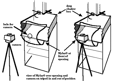

I’ve enjoyed reading all the info on photographing jewelry. I
do have a question though. How do you keep the camera
reflection off the jewelry piece. I take my pictures outdoors
on a foggy or overcast day with my camera on a tripod, usually
looking down on the jewelry, hence, in my slides there is my
camera! Thanks in advance for all your help.
I sometimes cut a round hole the diameter of the lens in a large
sheet of drawing paper, os that lust the lens is aimed at the
subject. I’ve also draped everything with a sheet if necessary-
10 years ago I photagraphed an entire collection of paintings in
reverse on glass, the most reflective thing I’ve had to deal
with.
Rick

You can cut a hole in a sheet of paper and slip the lens through
that. It will hide the bulk of the camera.  The only reflection I
haven't figured out how to hide is the circle of the lens itself.

How do you keep the camera reflection off the jewelry piece
I do it indoors and use paracute material with a slit for the
lens, daylight bulbs outside paracute material. I try to position
the peice so you dont see the camera.
Mark P.

Lisa:
You can move the jewelry so the reflection doesn’t show in your
viewfinder or ground glass or at least is less recognizable. You
can also (and probably should) tent the jewelry. In one of my
posts I talked about a rolled up paper tube to diffuse the light.
You would do about the same thing, except use a sheet or
something more flexible and surround the jewelry, just cut a hole
in the fabric for the lens (only) to show thru. The reflections
you will get will be of the white sheet. Any good book on camera
lighting will show some of these setups so you can get the idea
— a picture of it will be worth 1000 words. Techniques for
removing the little reflection of the lens itself would be real
complicated, but it shouldn’t be noticeable and if it is use a
longer lens and back off. The other thing you can do these days
is have your photo computer retouched and have them take out the
reflection of your camera. Depending on the time you have for
photography and your skill level, this might be easier if the
photos are OK otherwise. I don’t know what the cost would be but
one local retoucher told me they charged by the hour. cost would
depend on how complex the retouch was, and this doesn’t sound
very difficult — fve minutes work. Hope this helps.

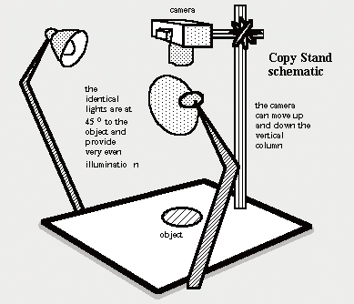

I’ve been using a copy stand for my photography, using a 1x or
4x lens over my 50mm standard lens. I marked places on the copy
stand for each of the two lenses. I bought a verylarge wooden
embroidery hoop, and then used a light weight nylon fabric, like
parachute cloth, place on the hoop. I cut out a place for the
camera lense to poke through. The copy stand comes with two
attached light fixtures, which can be individually positioned.
I use blue bulbs. I also use a remote cable to release the
shuttle. So far, so good! m I keep it on my dining room table,
so it is always ready for a shot, before the work is shipped out.
(this in a long line of invasions of my house-space!)
