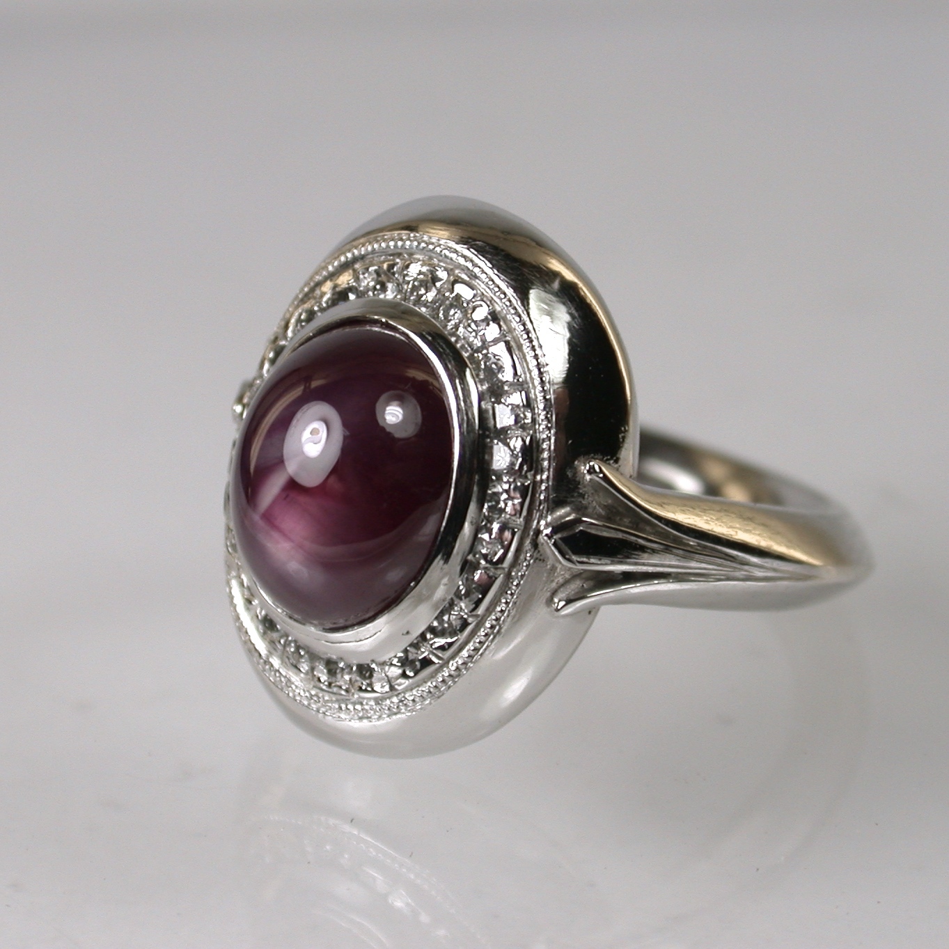

My friends went a traveling… wound up in Burma, land of MANY gems…
Michelle fell in love with this star ruby about 2.80 ct, very nicely cut.
She wanted something simple, a pinky ring.
Paul’s turn to provide Christmas…
End result, a surprise , hand fabricated in platinum and diamonds.
Good job Paul…
Enjoy,
Jim
