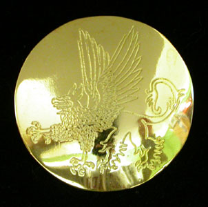

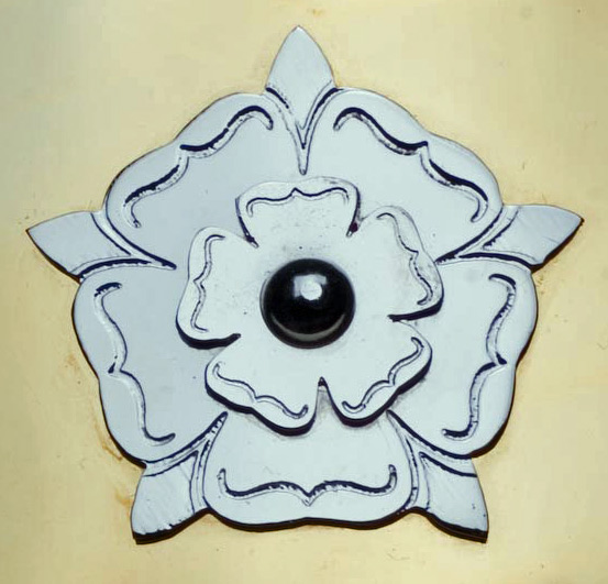

What are you using for a light source? I tried a couple of different
bulbs and finally settled on halogen flood lamps. I generally expose
for approximately a minute at about 8-10 inches away. A typical piece
for me would be something like (approximately 1.25 inches across):
http://www.ganoksin.com/ftp/griffin_brooch.jpg
or about an inch across:
http://www.ganoksin.com/ftp/tudor_rose_large.jpg
