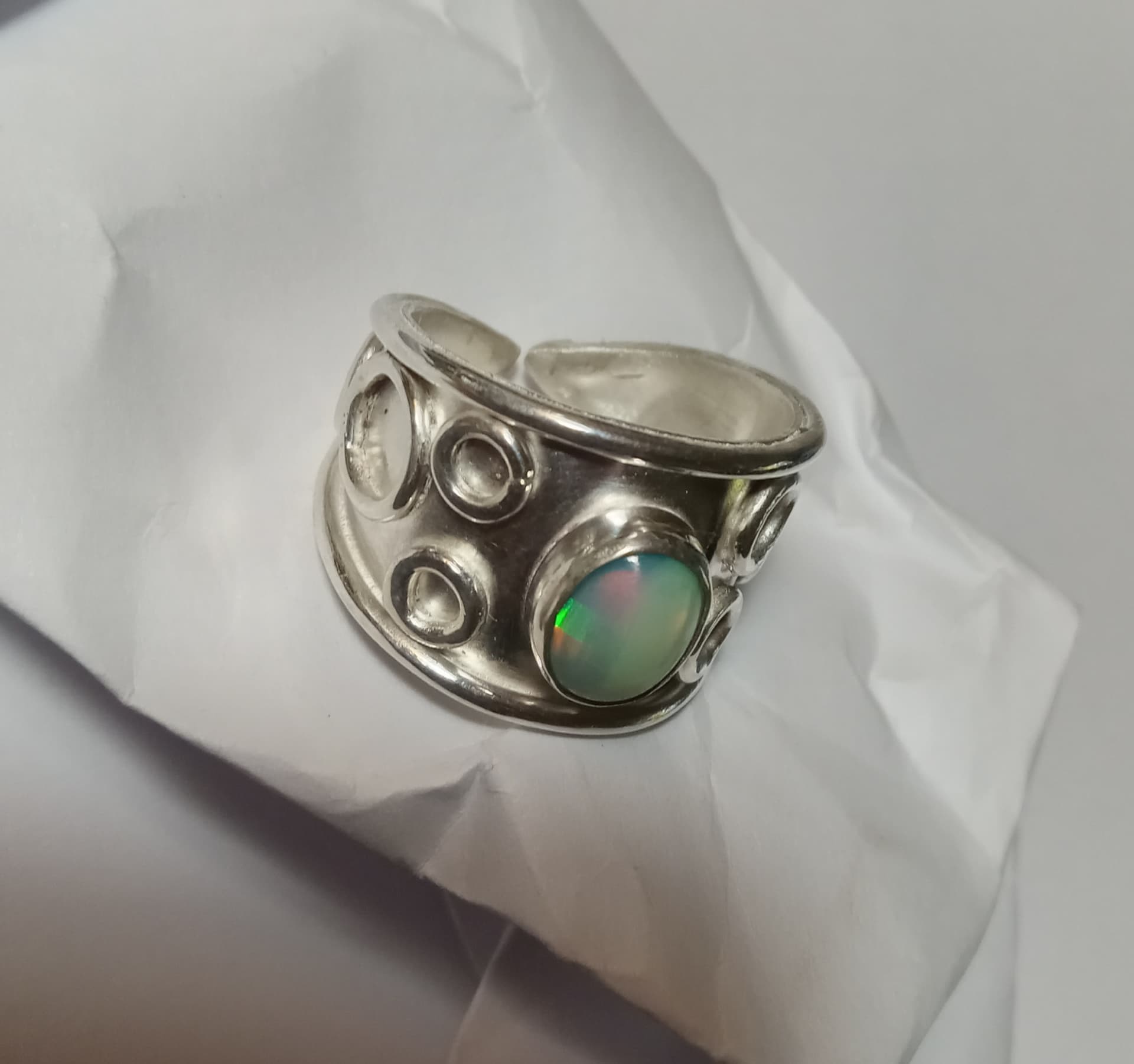

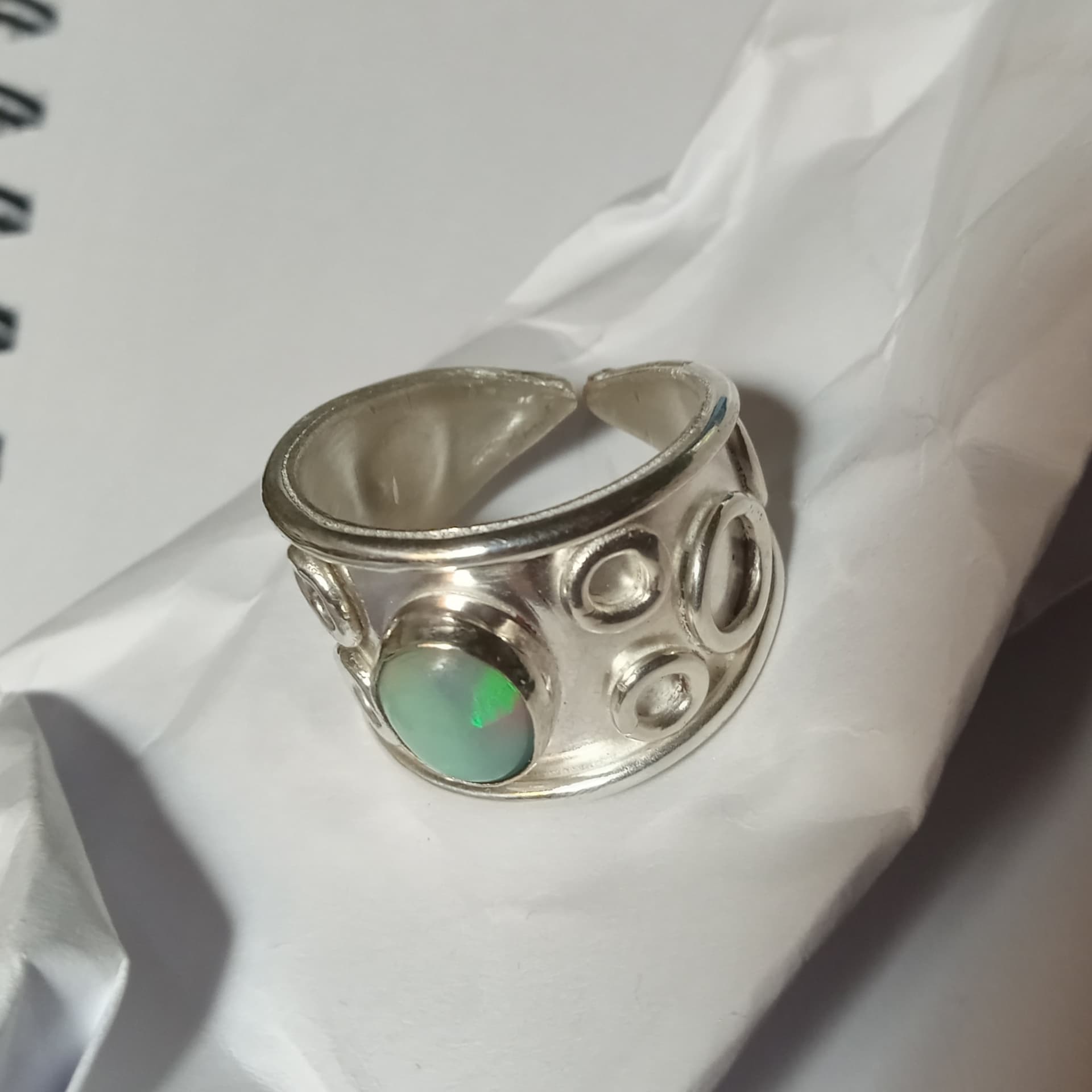

The argentium aspect isn’t relevant to my question but I thought I’d add it to the subject line anyway. I just started playing with argentium in the past couple of weeks and am really enjoying exploring new possibilities - learning new tricks always energizes me. I make a lot of simple textured wrap rings with stones, but this one is different because of the border, taking advantage of argentium’s fusing capabilities. There are some bugs in the ring to be worked out for the next one, for sure, but I’m happy with the experiment.
My question is about polishing out the inside of the little circles. What’s the best tool for that? Many thanks
A soft shaped rubberized abrasive would work, but a Q-tip charged with rouge should also do the trick. You could polish it by hand, but you could also cut the stick of the Q-tip to about an inch and pop it into a flex shaft or Dremel.
