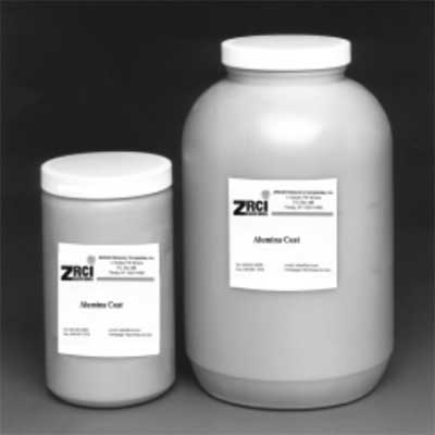

mine came already. I punched pay by check --it accepted this at no
charge. It looks to be much thinned collodial alummina solution that
normally might be used as a fiber insulation hardener with boric acid
as the flux. see
The Cas numbers on the Msds go along with this— It does make
sense.
