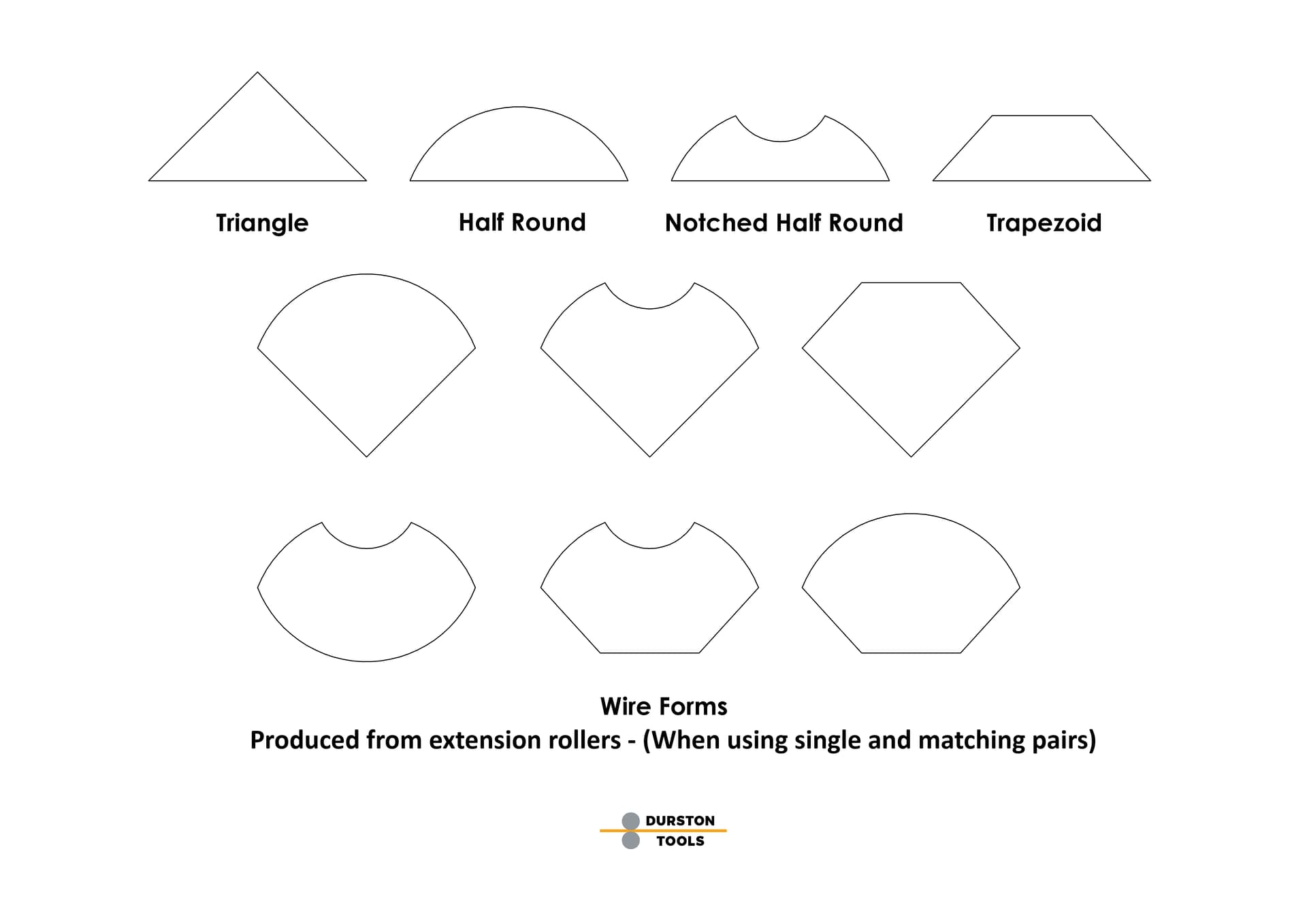

Unrelated to torches, but part of the same Otto Frei sale, I see that Otto Frei is carrying a new Durston Agile rolling mill that comes with extra side roller shapes. It’s also might be the first rolling mill that I’ve ever seen that isn’t gray.

I was looking at those rollers. I wonder if they make square and flat profile extension rollers.
Doesn’t look like it. If you talk to Otto Frei sometime you can ask them. They’ll know.
Some years ago the Durston website had shown quite a variety of side rollers, but at the time I looked there didn’t seem to be a way to order them, or maybe the price was out of my range. Senior memory.
It is worth looking into if you are interested, and perhaps the new rollers will be made available for individual purchase.
Please share if single rollers are available.
Neil A
After I bought my Durston mill with outside rollers years ago, I went through a long protracted conversation with Durston and Rio about a set of outside rollers that would roll triangular wire. At the time they showed such a roller on their website. I had to work through Rio and as the conversation progressed, it was clear that the cost of importing them and what I perceived as a general reluctance to do this business got in the way. My solution was to take the flat roller from my economy mill to my friend the retired machinist and he made me a roller that would roll several sizes of triangular wire and a special one that would do double triangular wire. I think that I paid him $75. You could do the same for square, flat, half round or whatever could be machined for the cost of an economy mill and the machining. Good luck…Rob

Using Rob’s idea about having a machinist alter an economy rolling mill, I’ll bet you could get a machinist to alter a Durston side roller to a different shape.
At my job, we have a Durston double mill with side rollers. It’s very easy to pull the side rollers off. About once a year or as needed, I pull off the side rollers and put them on a small Unimat lathe to polish and keep them clean.
My guess is that someone with a larger lathe and enough experience could easily change the shape on those Durston side rollers. Obviously, there’d be limitations with shapes, but my guess is that turning 1/2 rd into a square shape should be accomplishable for instance.
When I bought my economy mill that has zillions of replaceable roller options I got so excited about the concept that I reached to Pepe and suggested that they do something similar. Pepe said that it was too complicated. My guess is that Durston feels that same.

Durston does have new side rollers now, where you can mix and match the shapes. i was looking at these the other day, but need to wait for art fair season to start to invenstigate where to buy. They look reall cool though.
https://durston.com/product/shaped-extension-roller-set-for-drm-130-150-elite-140/
That’s cool. Some fun combinations possible
