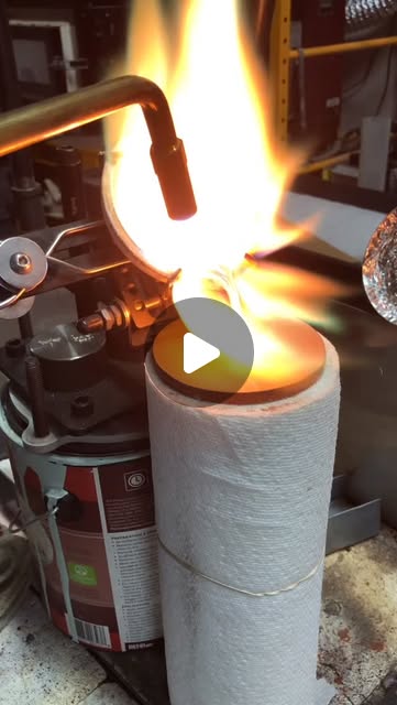

Craig dabler- sand casting a long ingot using a paper towel roll
Hi,
I saw this and thiught i would post it.
(i thought of Rob and his bracelet stock needs)
julie
hi again,
oh! here the guy is using a tube…metal or plastic…and a knitting needle of the desired diameter…and he has invented a vacumn base…people are so creative!
i wonder if drilling holes in the pipe, and then poking air vents, while packing, and then pulling them out before piking the model rod in, would work without needing a vacumn…
julie
Pretty cool, well, maybe hot. I do use a 1.25” PVC pipe long enough to cast an 8” long ingot that might be 3/8” in diameter. Adding the vacuum might be a good idea as it doesn’t always go so well. Thanks for sharing…Rob

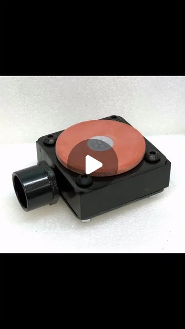

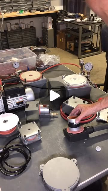

Hi,
i just saw, on instagram, that craig dabler slso has a small vacumn unit for sand casting.
used with a household vacumn.
i thought i would share.
julie
hi,
interesting video…mentions “blowouts”…from too thin sand layer at bottom…interesting…
julie
