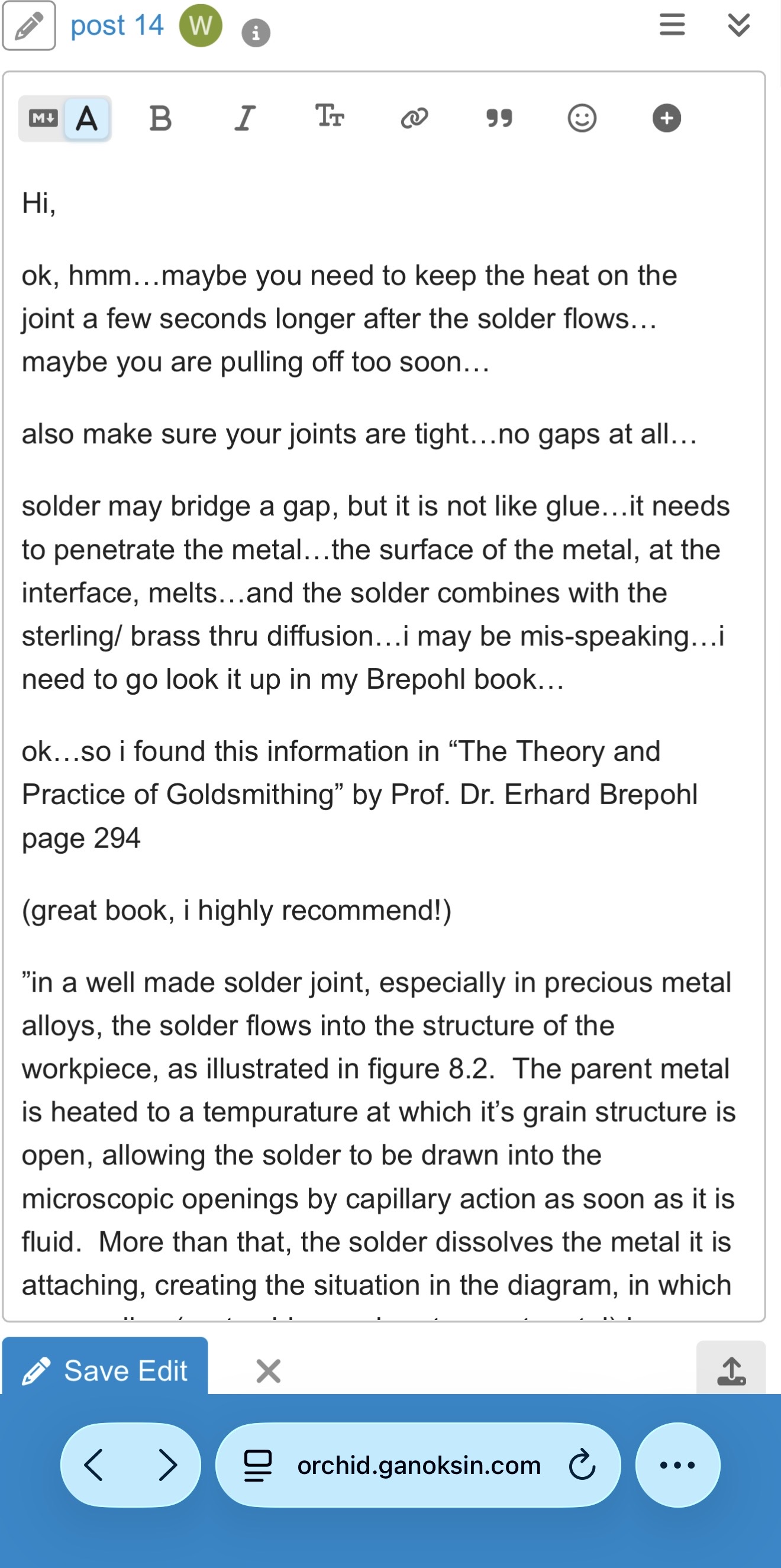

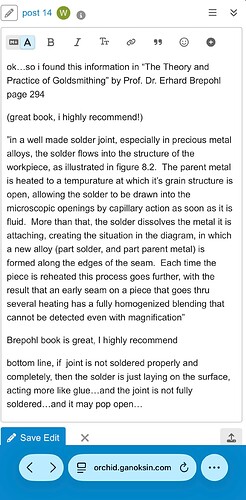

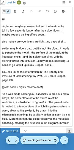

ok, hmm…maybe you need to keep the heat on the joint a few seconds longer after the solder flows…maybe you are pulling off too soon…
also make sure your joints are tight…no gaps at all…
solder may bridge a gap, but it is not like glue…it needs to penetrate the metal…the surface of the metal, at the interface, melts…and the solder combines with the sterling/ brass…and then i “think” the solder mixes with the surface metal and the melting point is lowered right there and it melds together…i may be mis-speaking…i need to go look it up in brephol book…
maybe someone here can explain this phenomena better…
bottom line, if joint is not soldered completely, then the solder is just laying on the surface, acting more like glue…and the joint is not fully soldered…and it may pop open…
perhaps as an exercise, solder a bangle, and then twist the ends with pliers and see if it pops open…

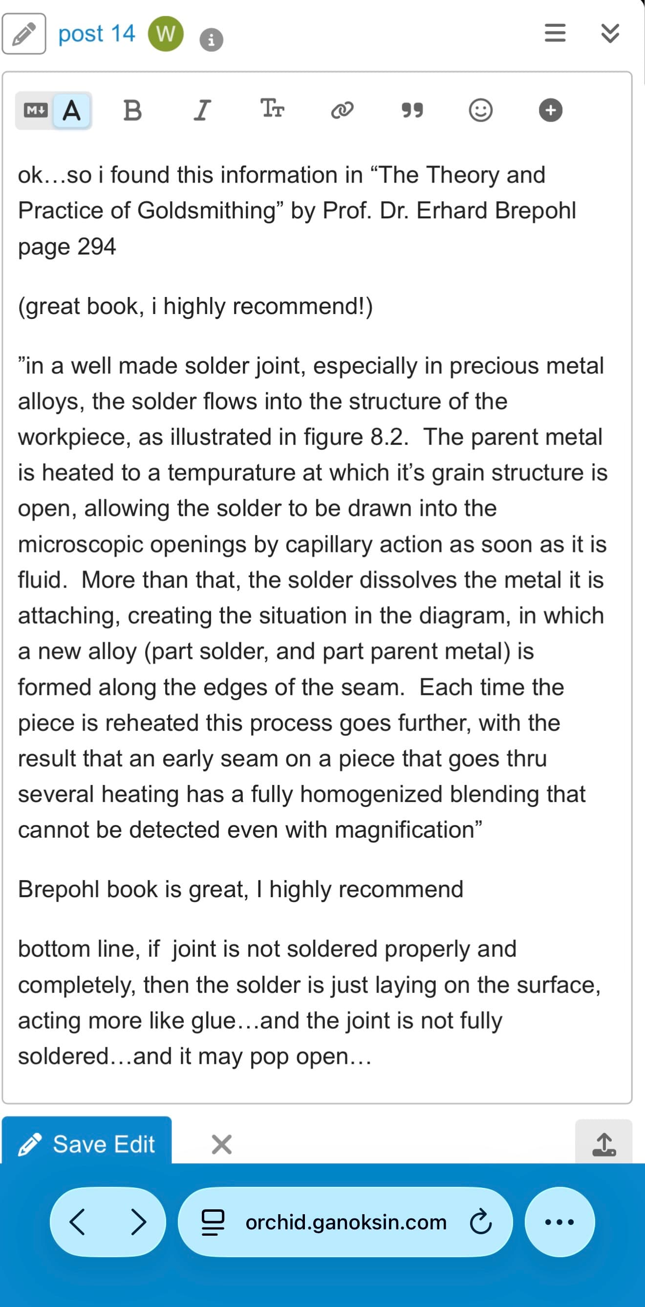

this article kinda talks about what i am trying to say…
here is another article…talks about using enough flux…if the flux gets “spent” oxidation can occur and lead to a weak joint…

(I tried to edit my above post, but i timed out…see below revised)
https://www.amazon.com/Theory-Practice-Goldsmithing-Erhard-Brepohl/dp/0961598492
