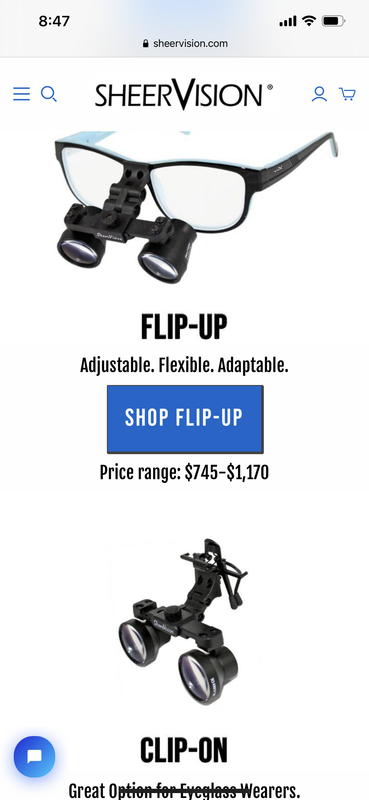

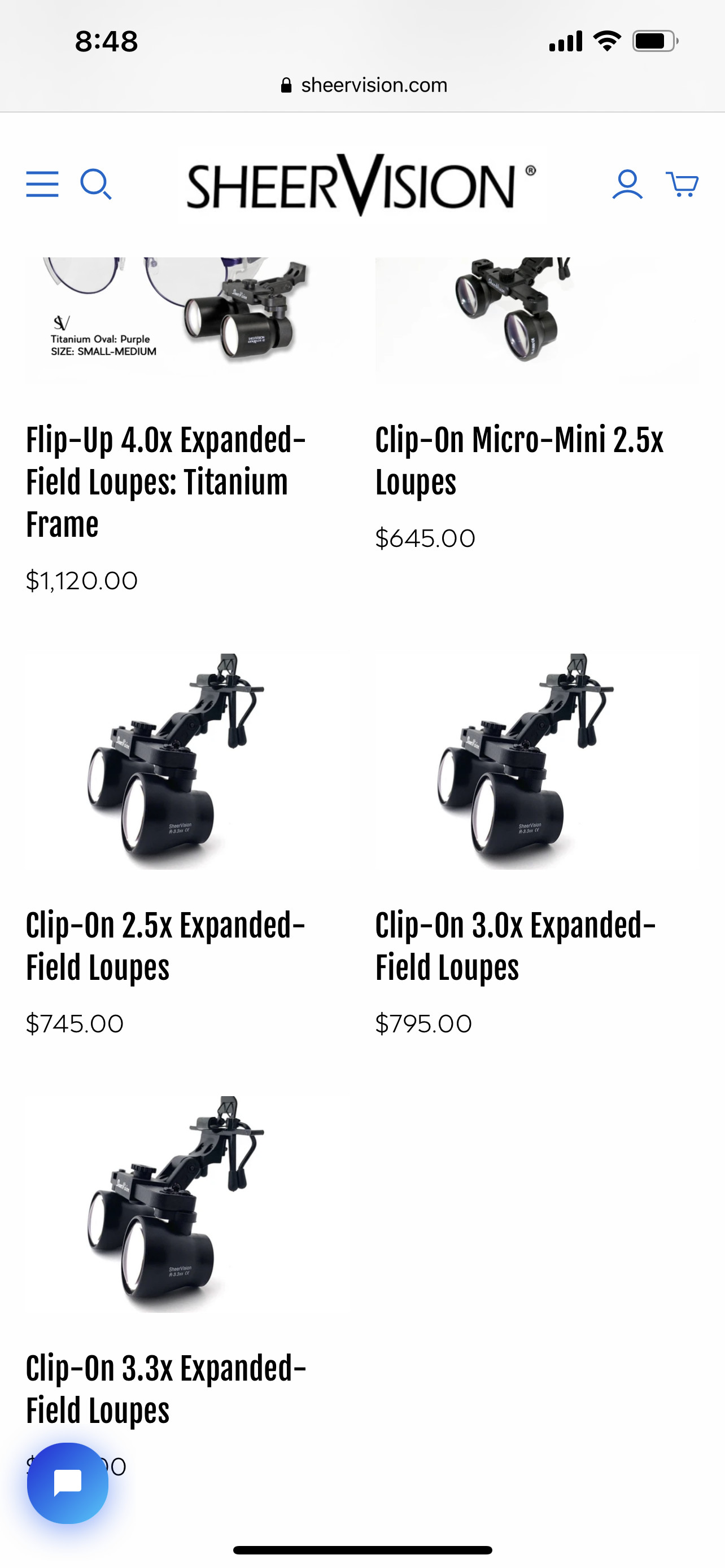

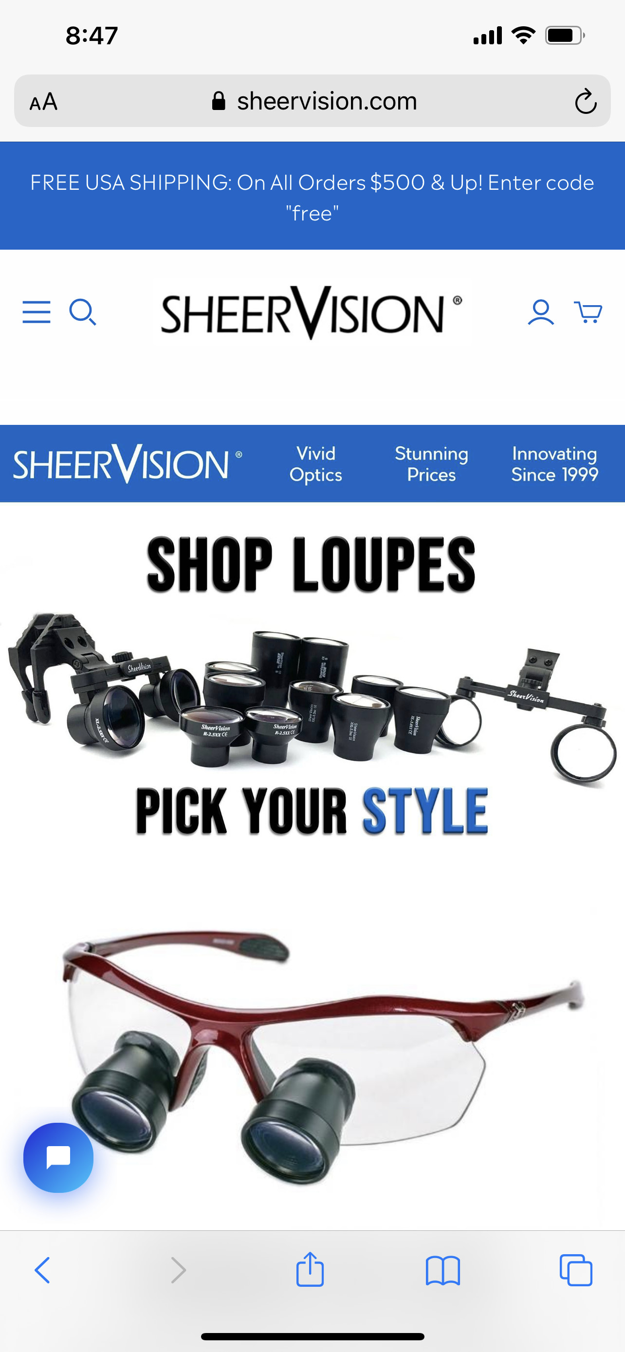

hi Neil,
I must correct myself!
i dived in deeper and saw that they do indeed also offer flip up,?snd! clip on!
and yes, they offer a bigger range of magnification!
on their banner there is a pair with circles…looks like for interchanging loupes…?…
very interesting!
thank you again!
julie

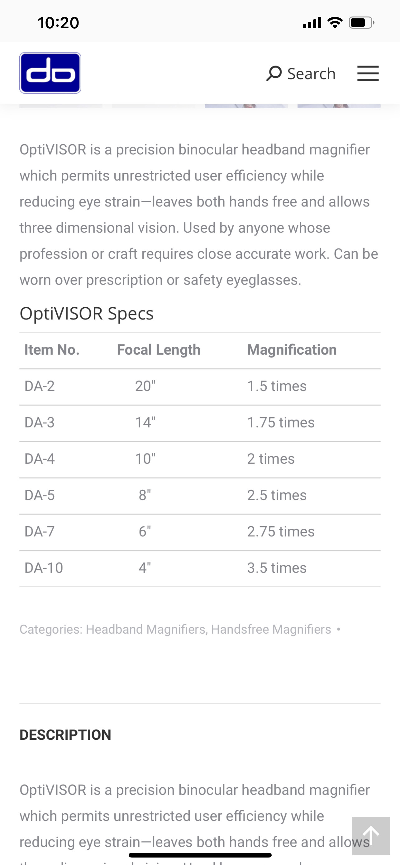

so…what i find interesting about the sheer vision binocular loupes, versus the optivisors…is that they have much longer WD working distances…i am trying to wrap my brain around that concept…
ie:
my #10 optivisors (3.5 times magnification)
have a WD of 4”, which can be a bit too close st times…
the sheer vision and CO loupes allow for more WD…
interesting…

The strongest Optivisor lens is the #10, which is 3.5X
Have one. Working distance is 4 inches. Try that for a while. Your eyes go cross-eyed, literally, at that distance. Headaches? For sure.

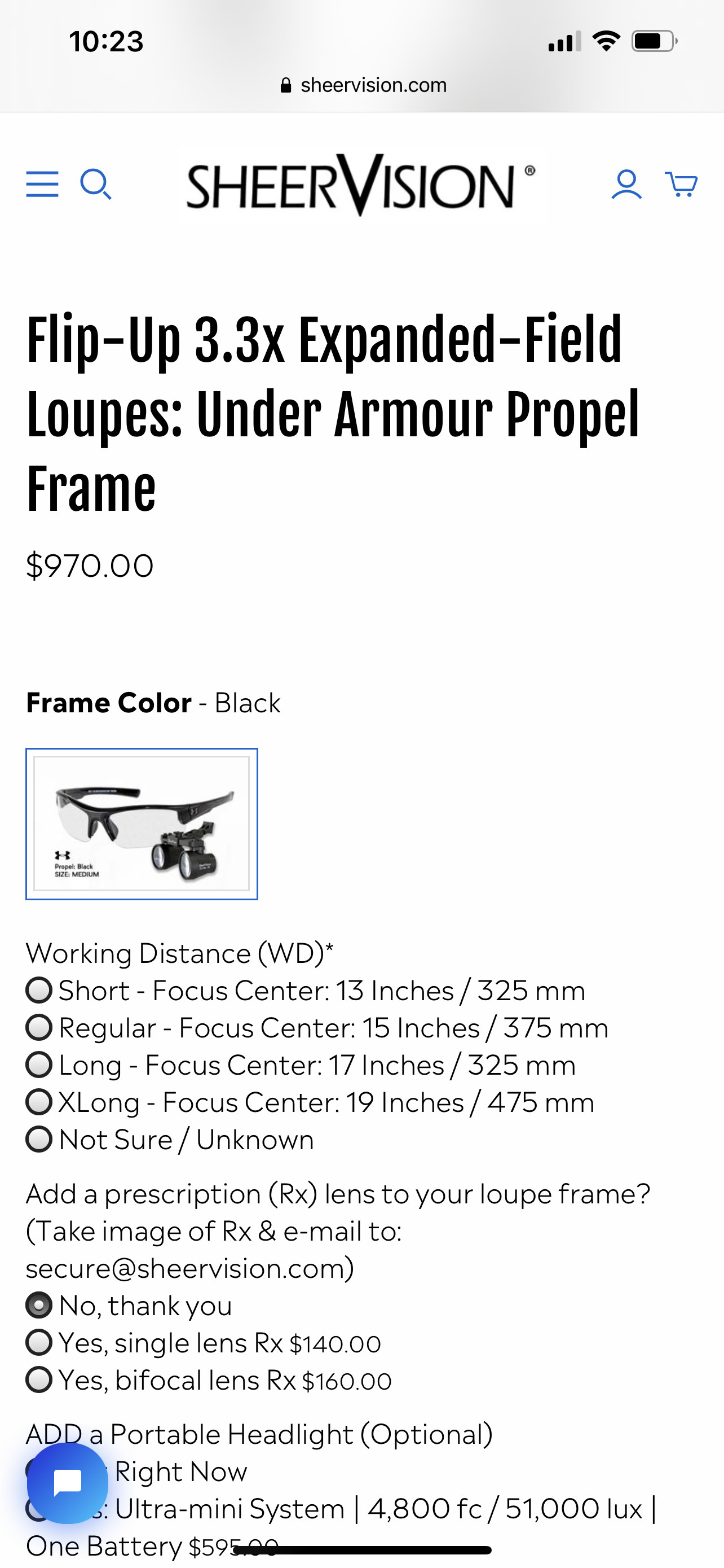

And I notice that the SheerVision flip up with bifocal costs over twice as much as the CO. The SheerVision lets you choose a higher magnification than CO, and that may in fact be needed if doing tiny detail or tiny stones and not using a scope. Interesting set of choices…

Neil, I didn’t see where you actually specified what you want, so IDK what would work for you. You’d have to specify your working distance and the magnification. As far as lighting, I have several lamps on swing arms I can move about and don’t yet have a ringlight on the scope. Maybe later. Headlamps can go with the glasses or be added on another band rather easily.

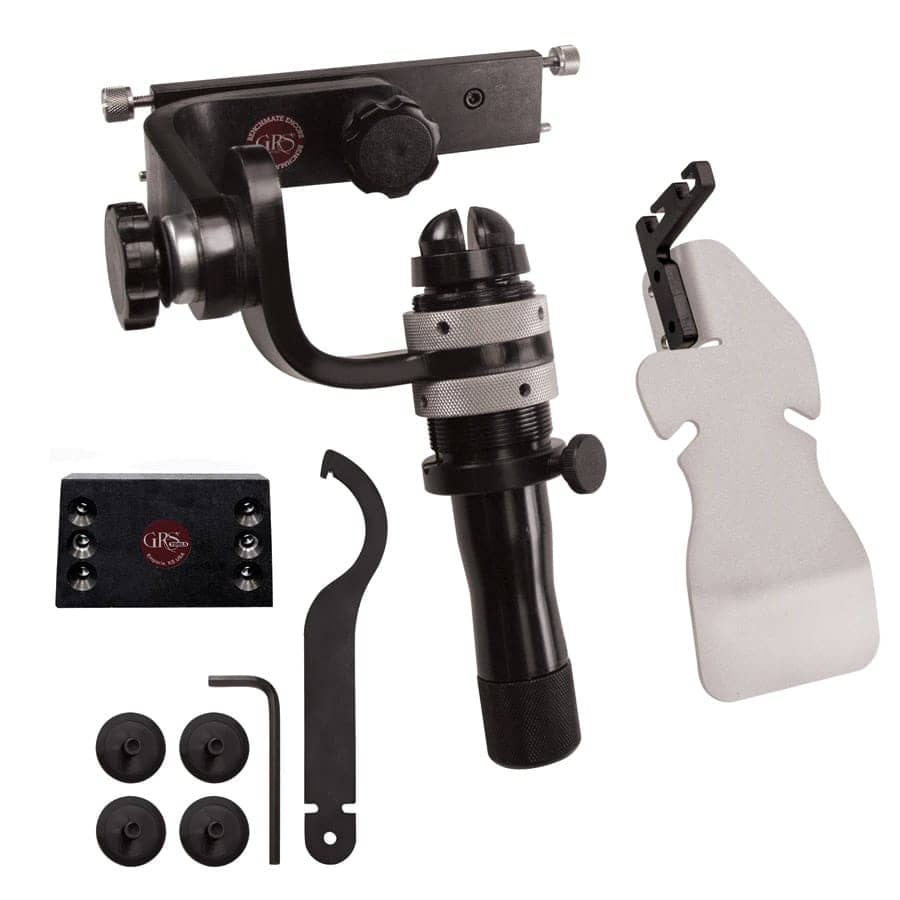

did i ever mention, regarding working under the scope, that the below new benchmate QCX has a bracket that stays centered…?
i have the original benchmate and GRS sold me the newn bracket components, which fits the original ringholder…big improvement.
julie
