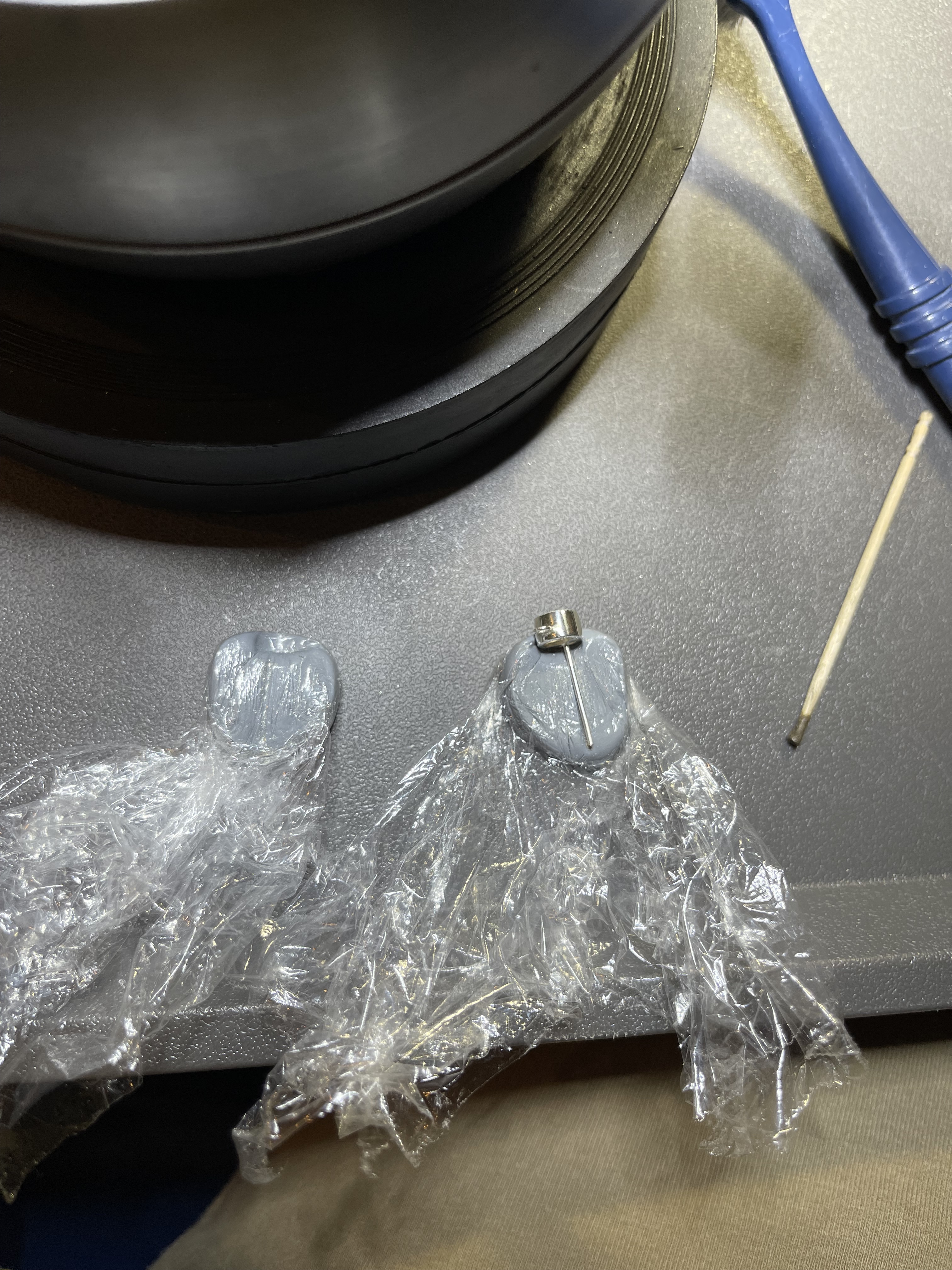

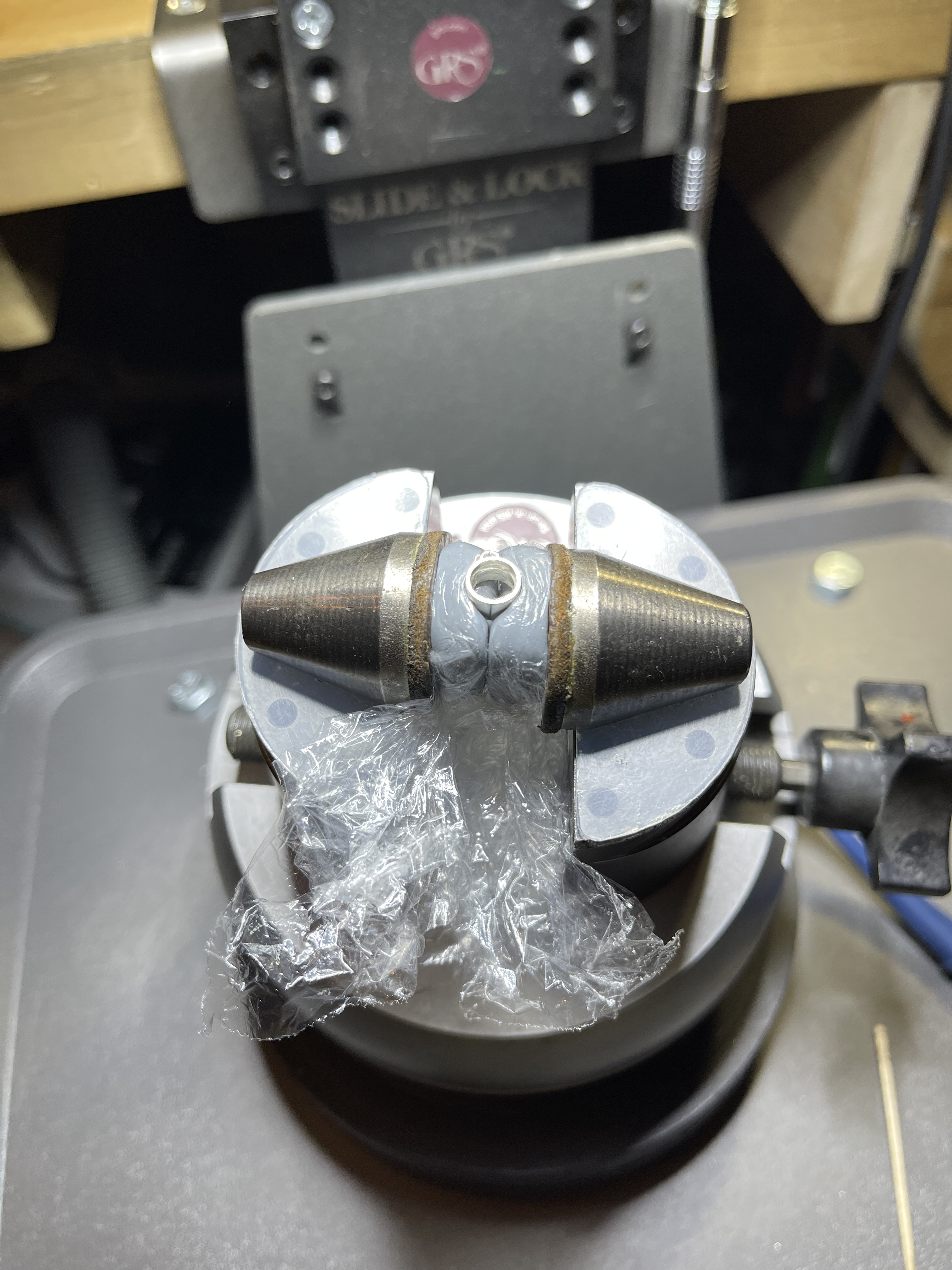

Hi,
ok…i remembered the saran wrap technique…
where i wrapped 2 small cubes in saran wrap, and tgen sandwiched the bezel in between while moderately soft
then i put this unit into my ball vice, not too tightly, and waited for it to harden, where a 2 piece fixture resulted…conforms to bezel, without embedding bezel…
julie
