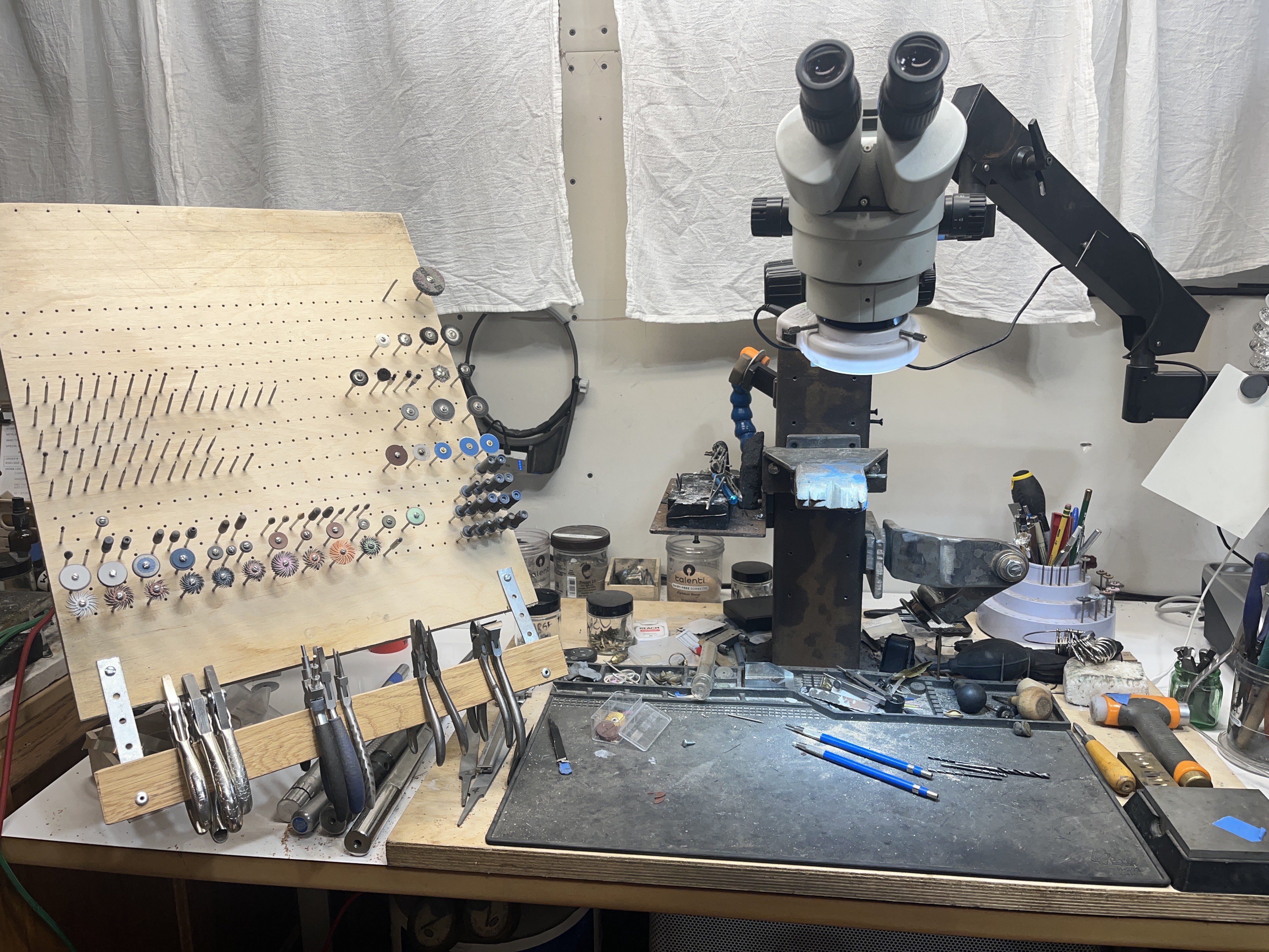

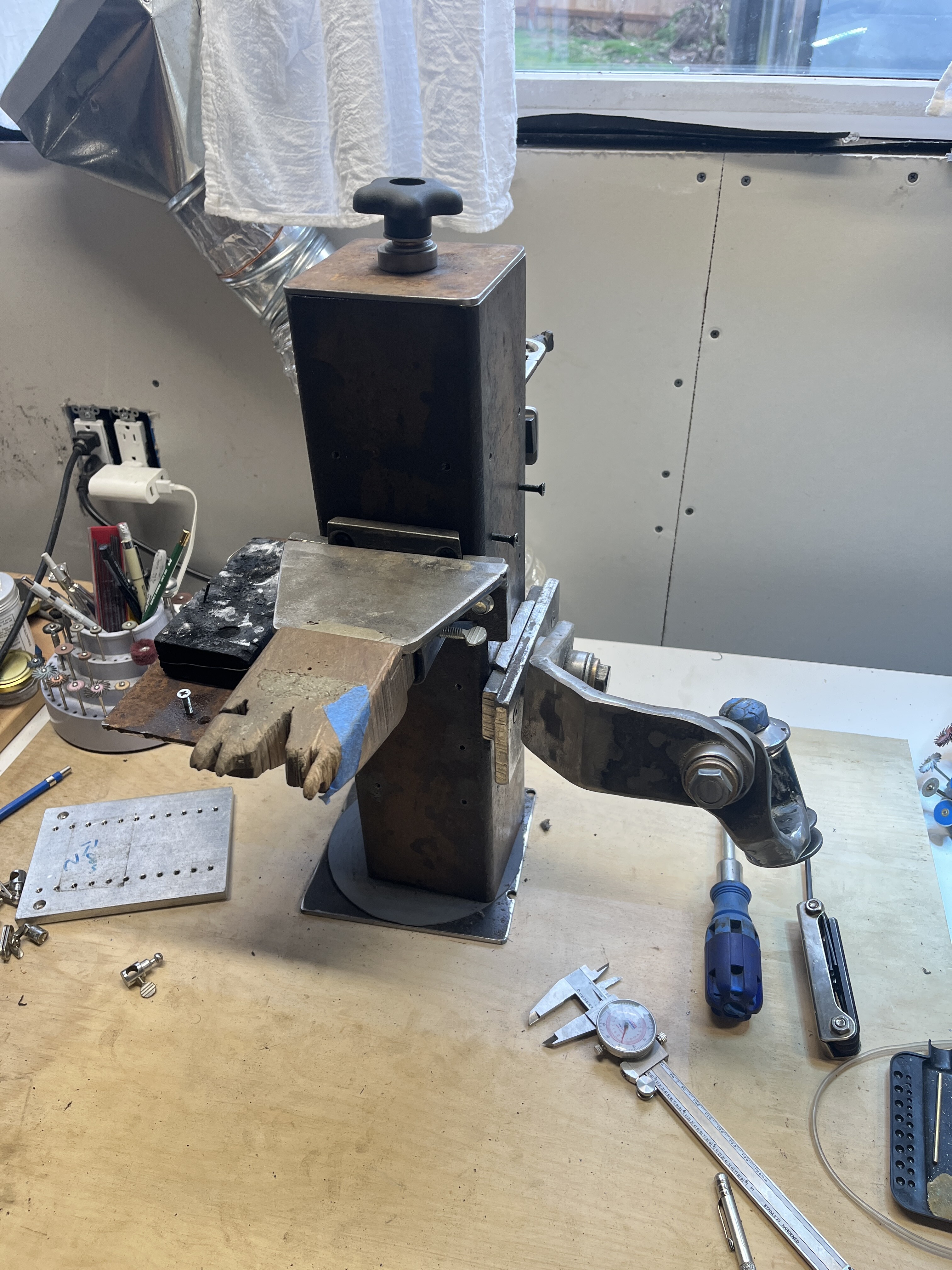

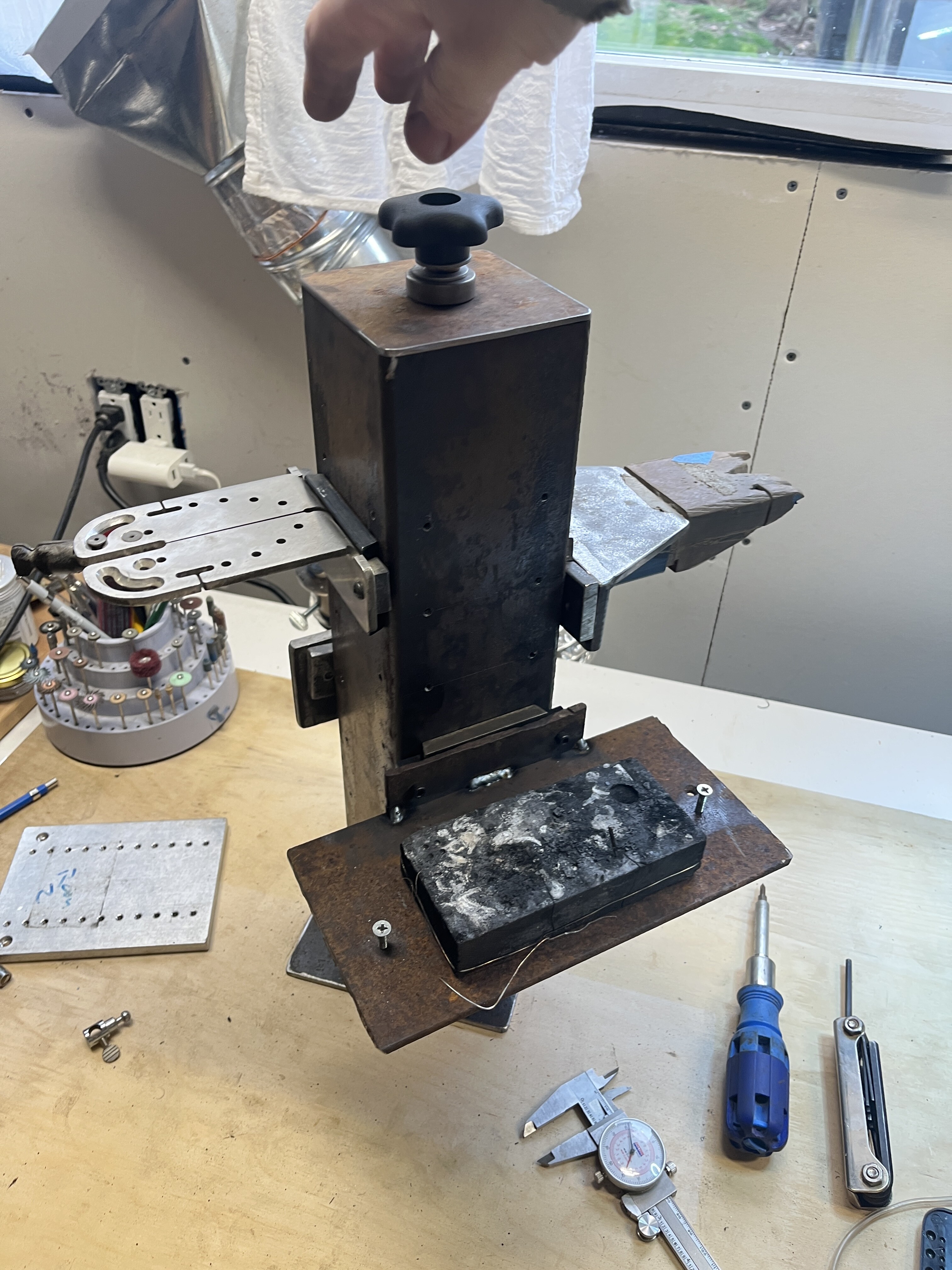

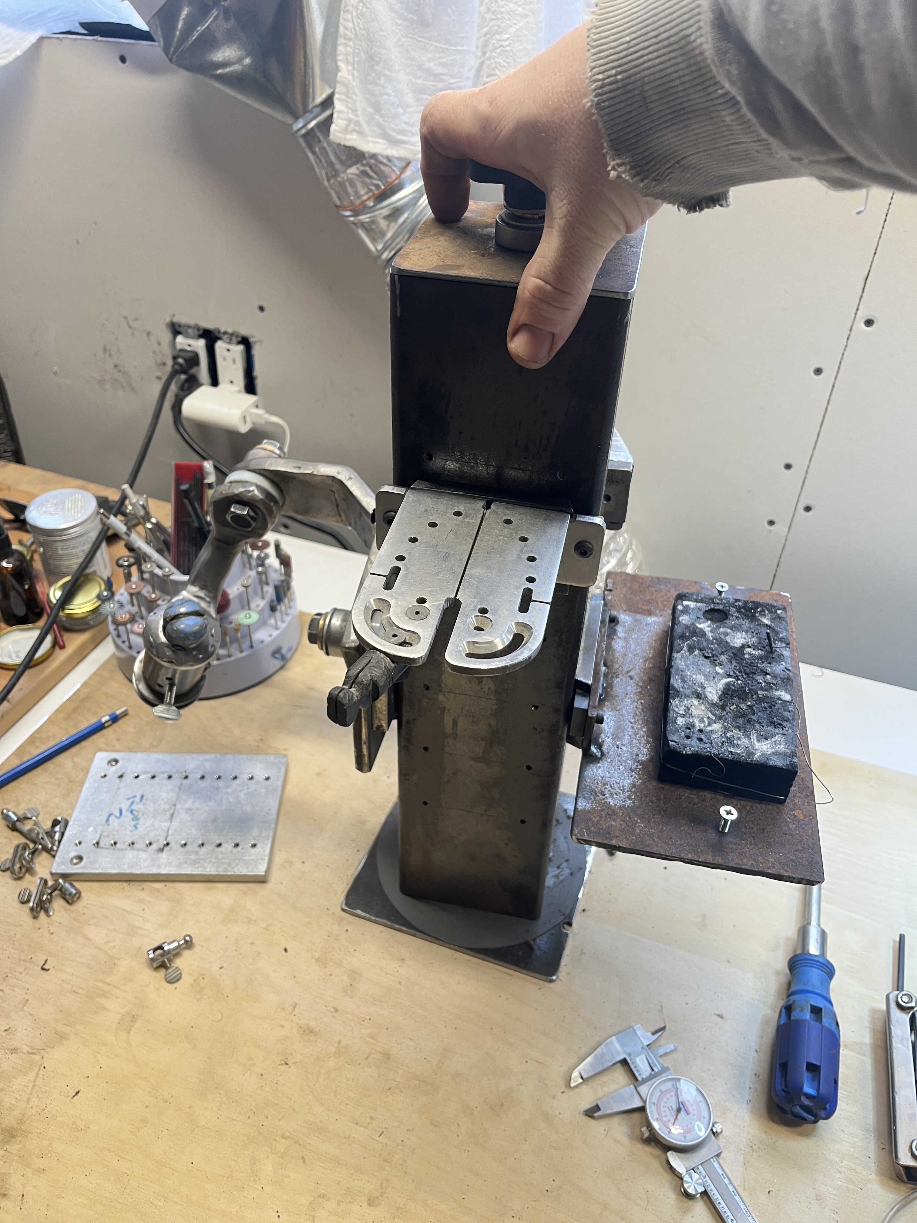

I am redesigning my work space inspired by what I saw at New Approach. Here are some pics.
I built all this with some scrap steel I had laying around and a piece of 1” birch plywood

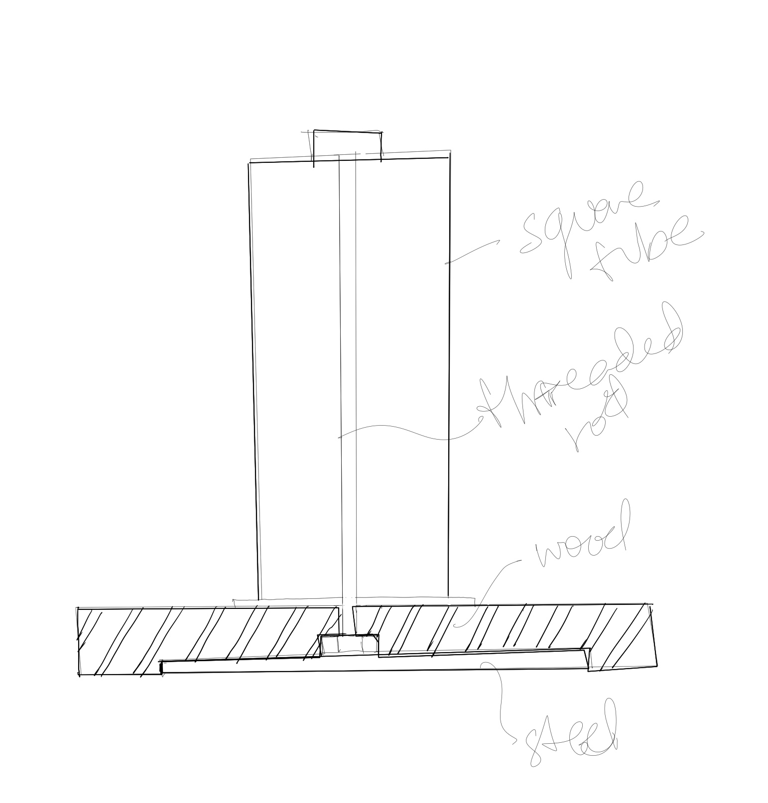

Hi Brendan,
so!…how is the tower unit secured to the bench…?
julie
You have been busy. I like making my own tools. Sometimes they work. Good job…Rob
There is a metal plate with a nut welded onto it that is set into the bottom of a 1 inch thick plywood piece. The bolt that runs through the tower connects to that nut and pulls the tower into the plywood base.
Here’s a quick image

Hi…so you clamp the plywood to your bench?
julie
No need. It’s big enough that I just put some neoprene between the worktop (an adjustable desk so I can change ergonomics for me or my wife) and the plywood. It doesn’t budge.
So Clever. You should reach out to Potter and see if he would make loads of them. I would buy it!
Just to be clear, this is an actual product they sell at New Approach and it’s definitely worth purchasing it there! I just have a habit of cobbling together tools because I have the insanity to do it.

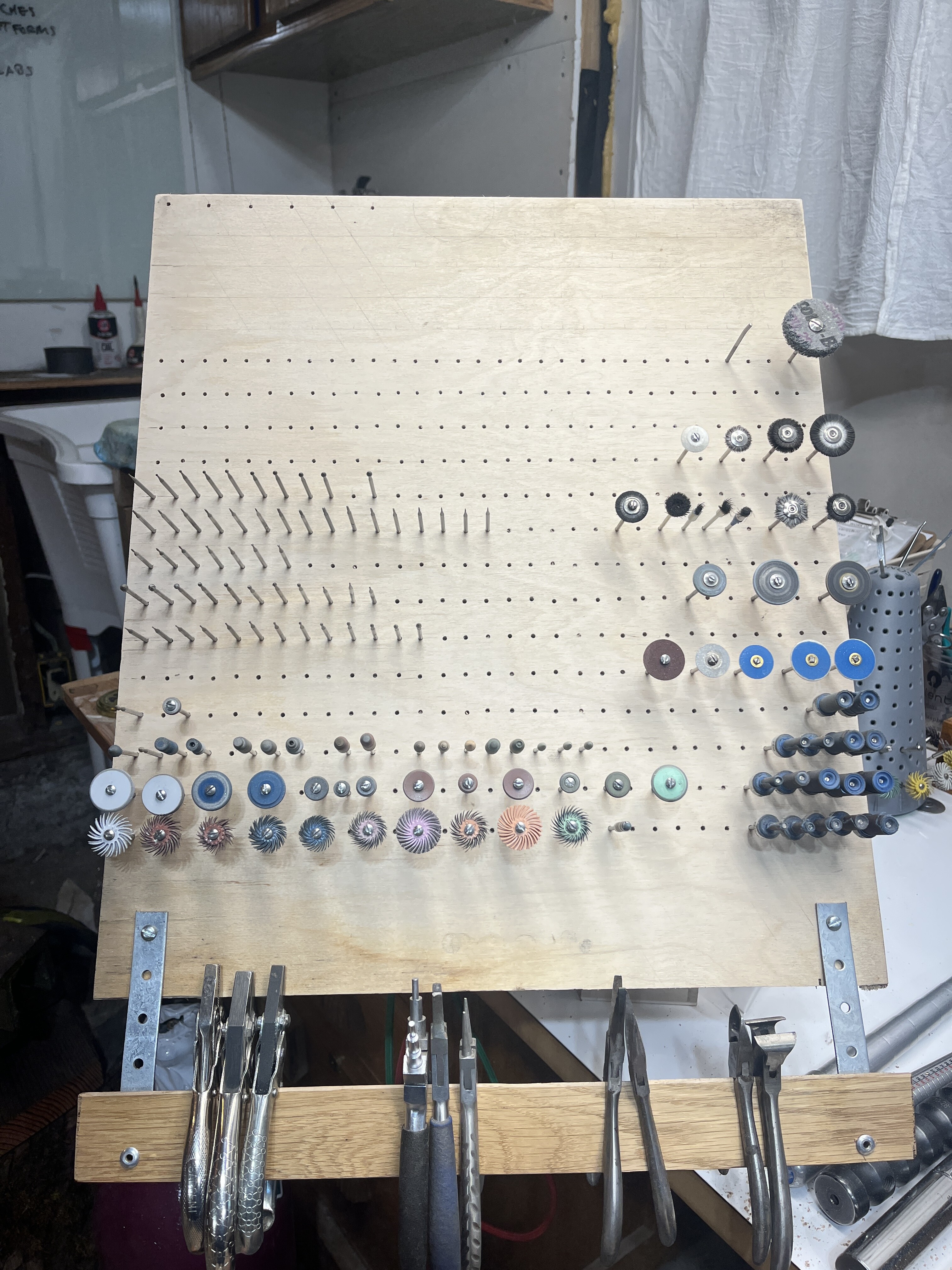

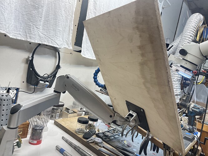

Another update. A new bur holder and pliers organizer. It’s on a reclaimed monitor stand.
