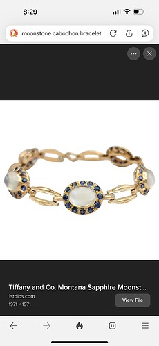

as far as soldering position, i saw a vintage tiffany sapphire and diamond link bracelet which had sort of teardrop shaped “jumprings”…where the ends were pinched and flat (ie: like a fixed bail on a pendant) which allowed them to be positioned “lower down” at the “base” of the element…(the setting was not bezel wire, but the concept/ contact area size was similar)
i also saw a link bracelet that utilized a design element which incorporated the 90 degree loop (in place of a jumpring)…ie: like a fleur de lis element on each side of the bezel…where the 90 degree loop was incorporated into the center tip of the fleur de lis, as an example…the element allowed for more solder area, and strength…and became part of the overall setting, so to speak…it “belonged”…
julie
Hi,
maybe the pinched jumpring is a double wire, like your links…
